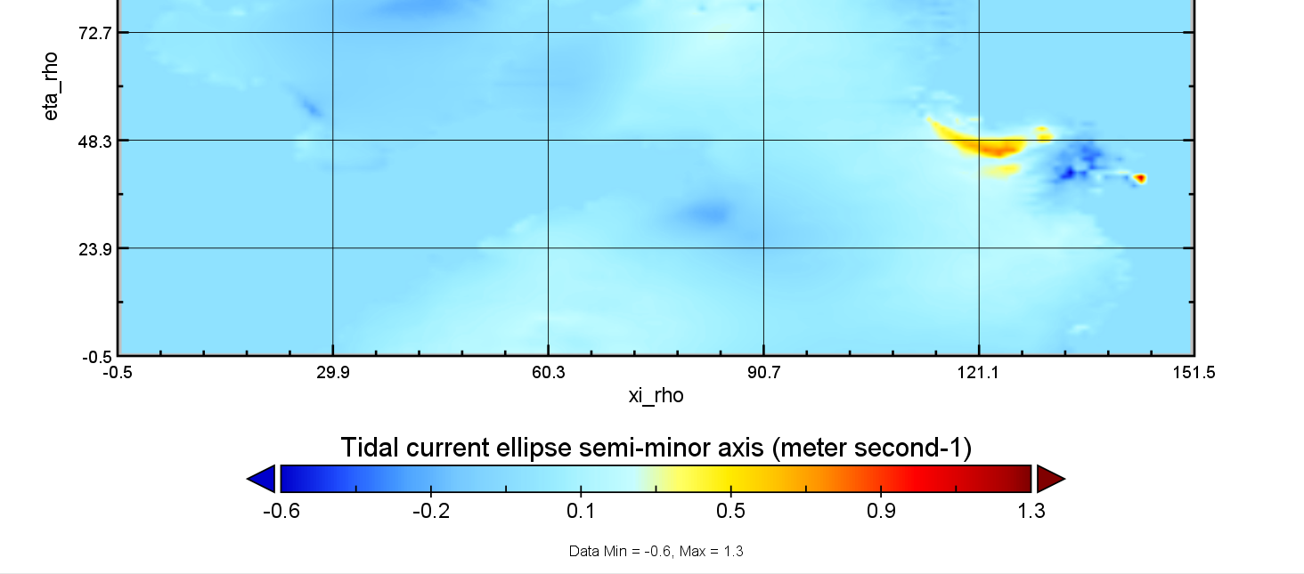

Everything is Ok, but i found ROMS failed to read minimum tidal current, ellipse minor axis
  GET_2DFLD   - maximum tidal current, ellipse major axis
                   (Grid = 01, Min =  0.00000000E+00 Max =  1.92168231E+01)
    GET_2DFLD   - minimum tidal current, ellipse minor axis
                   (Grid = 01, Min =             NaN Max =             NaN)
I dont know why this happened. I checked the value of tidal current
tidal current value
tidal current value
It do has value.
But l really don't know why ROMS can't read it.

#3 Unread post by wilkin »
It did read them. It's just telling you that somewhere in the file you have NaN values. They aren't on the boundary though otherwise ROMS would not have run.
