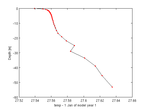

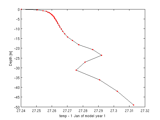

vertical profile
Hikate
I attached temperature vertical profile yield of Roms output near coasts I'm looking for near coast looks should be wrong, because depth is inversely proportional to temperature. Could you please tell me why are wrong?
Best Regards
F.Daryabor
Best Regards
F.Daryabor

Re: Fiting Coordinate system
Are these your initial conditions or some later state? Have you looked at your initial conditions? Where did they come from? You say this is temperature but the numbers and the shape remind me of density. What does the density look like? Is it the unstable bit in the middle that concerns you or the entire structure?
