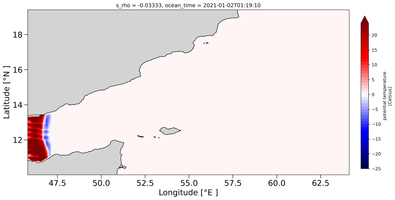

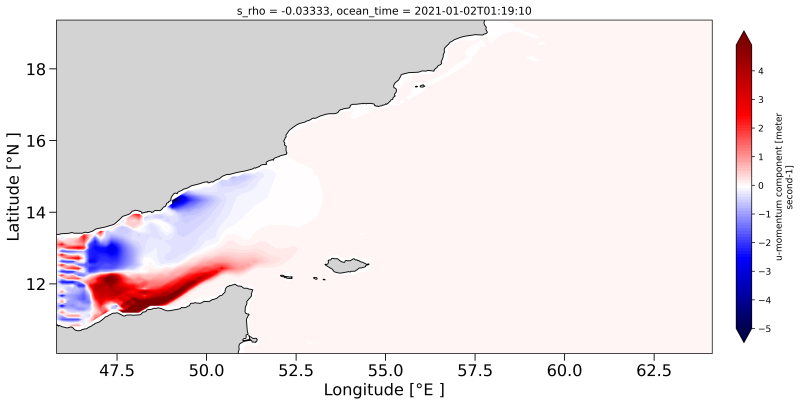

Please check out your lateral boundary conditions.
I saw many 0 value at eastern and western boundaries.
Also, when it blows up, could you plot horizontal u, v, temp, salt and upload here?
It might not the major cause but I doubt about your unit at the humidity. Are you sure that it is relative humidity?
-JH
Joonho Lee

Seems like your initial condition does not match with the boundary condition.
Could you plot your initial condition(u,v, temp, salt) here?
