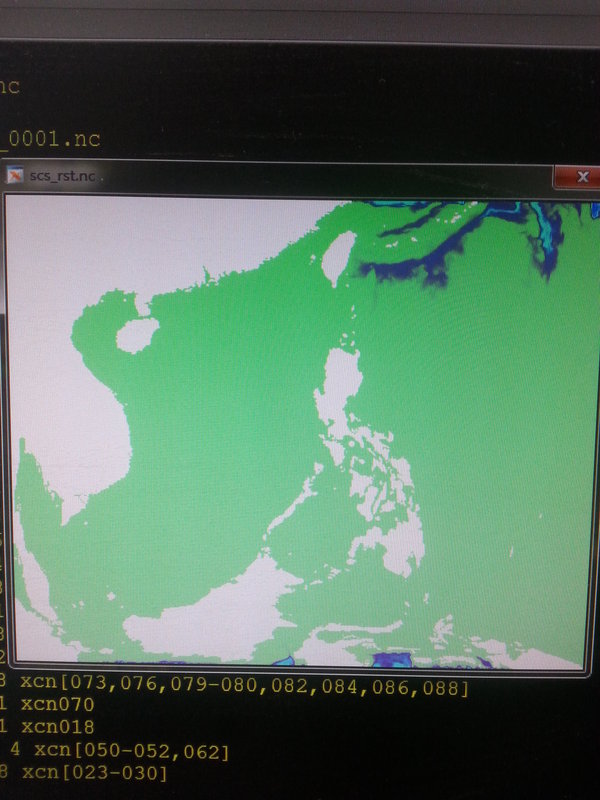

I am running the tides only model and keeping constant temp. But I have got the surface temperature as follow. I also found the temperature of all boundaries in the bottom layers are not constant. What's the reason for this?
Please find the attachment for my model's configure.
how to keep constant temp when running tide only modal?

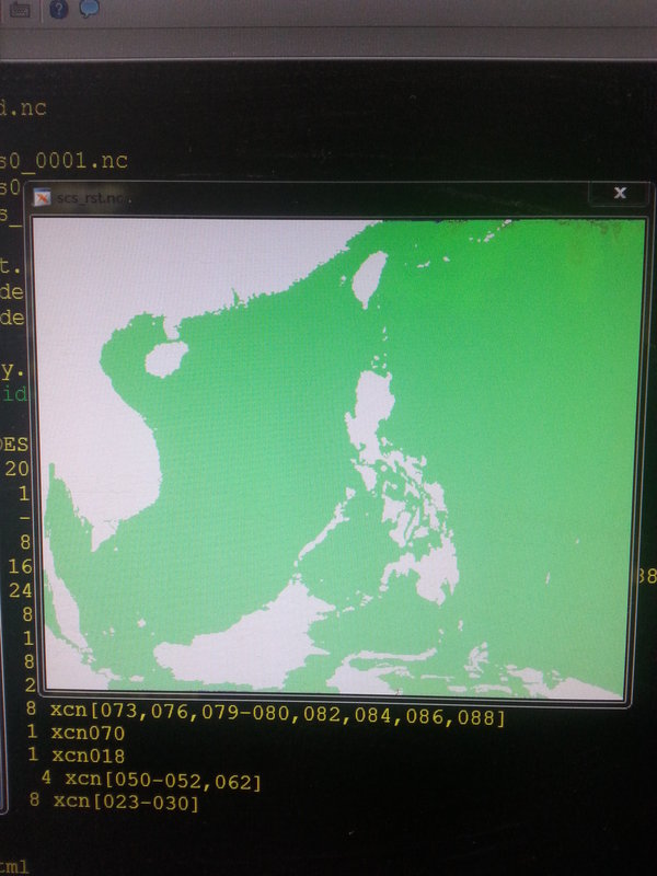

Though I have not defined TS_FIXED, I have set the initial conditions, OBC to T0(ng), and set the surface and bottom fluxes to 0, by ana_initial, ana_tobc.h, ana_stflux.h and ana_btflux.h.
So I really can not understand why the temperature can be changed still during the LOOP?

You don't need to define TS_FIXED for tide-only modeling. Just constant tempe/salt as you specified.
It looks to me that your problem may be something to do with open boundaries.
What's your cppdefs and ocean.in?
Also, why did you edit ana_tobc.h? I don't think I did that for tide-only modeling.
