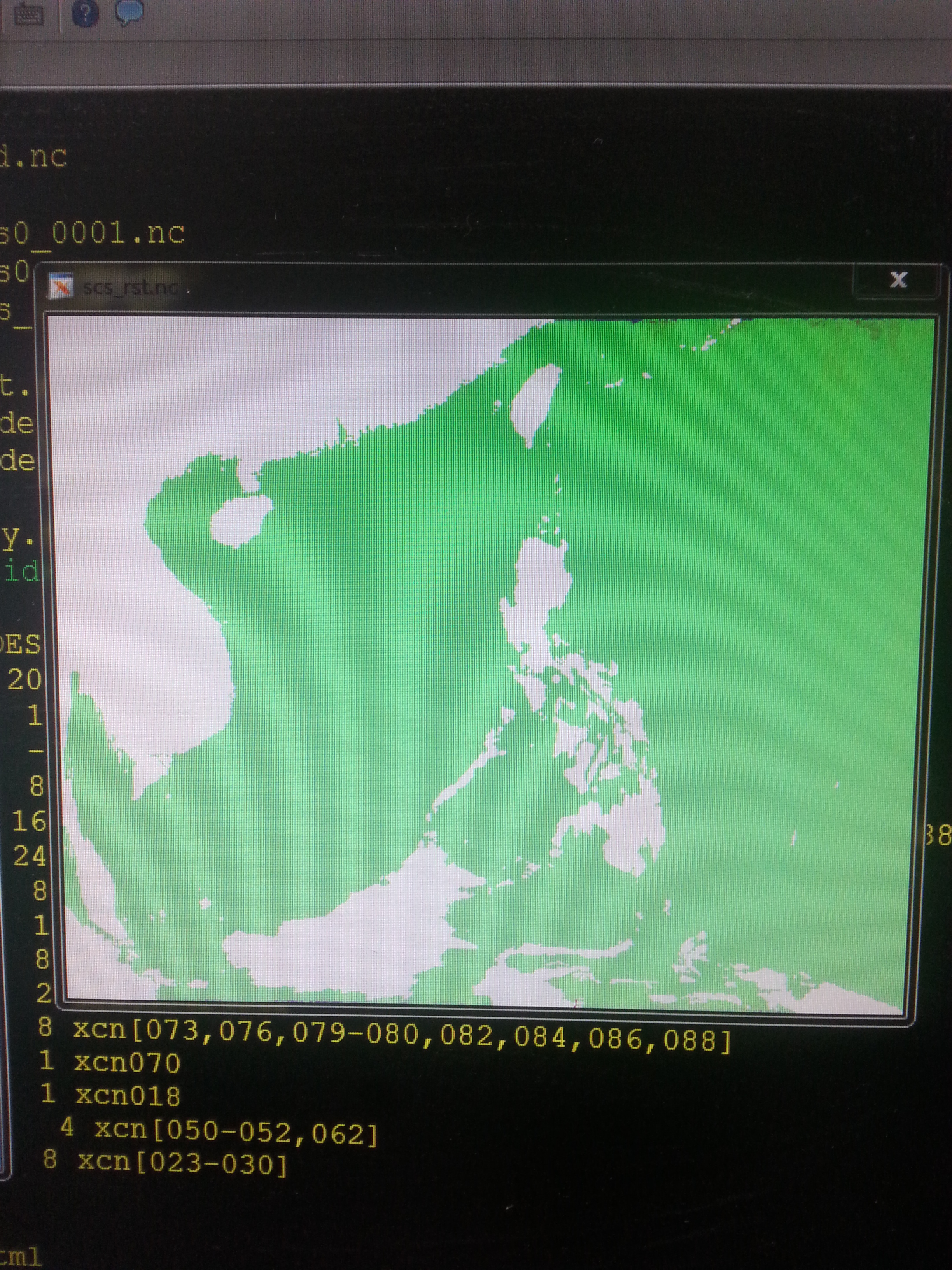

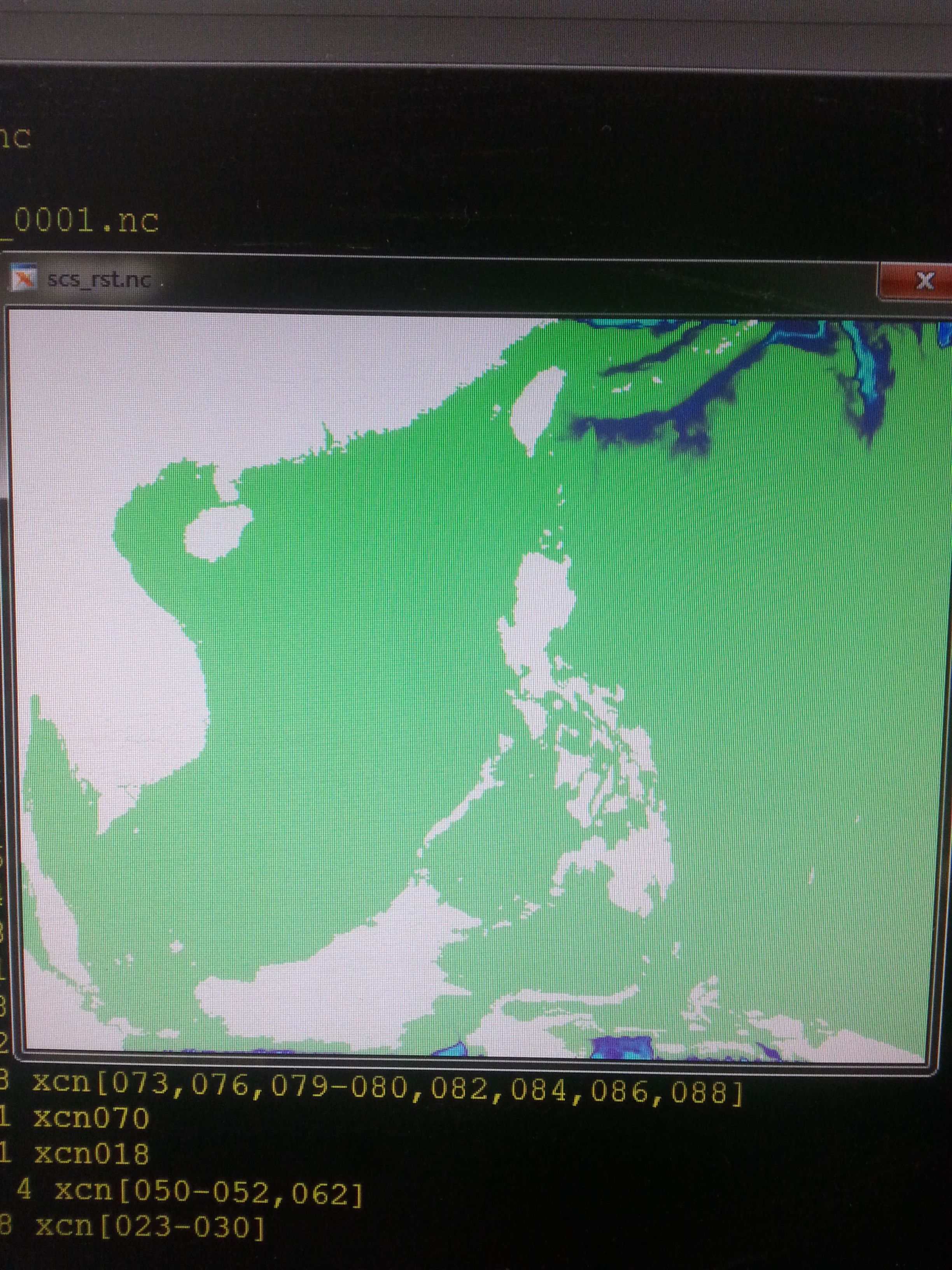

I am running the tides only model and keeping constant temp. But I have got the surface temperature as follow. I also found the temperature of all boundaries in the bottom layers are not constant. What's the reason for this?
Please find the attachment for my model's configure.
Temperature on the bottom layer
SST
SST
xiaozhu557
Posts: 62
Joined: Fri Sep 11, 2009 1:48 pm
Location: nmefc
Re: how to keep constant temp when running tide only modal?
#2 Unread post by xiaozhu557 »
Though I have not defined TS_FIXED, I have set the initial conditions, OBC to T0(ng), and set the surface and bottom fluxes to 0, by ana_initial, ana_tobc.h, ana_stflux.h and ana_btflux.h.
So I really can not understand why the temperature can be changed still during the LOOP?
