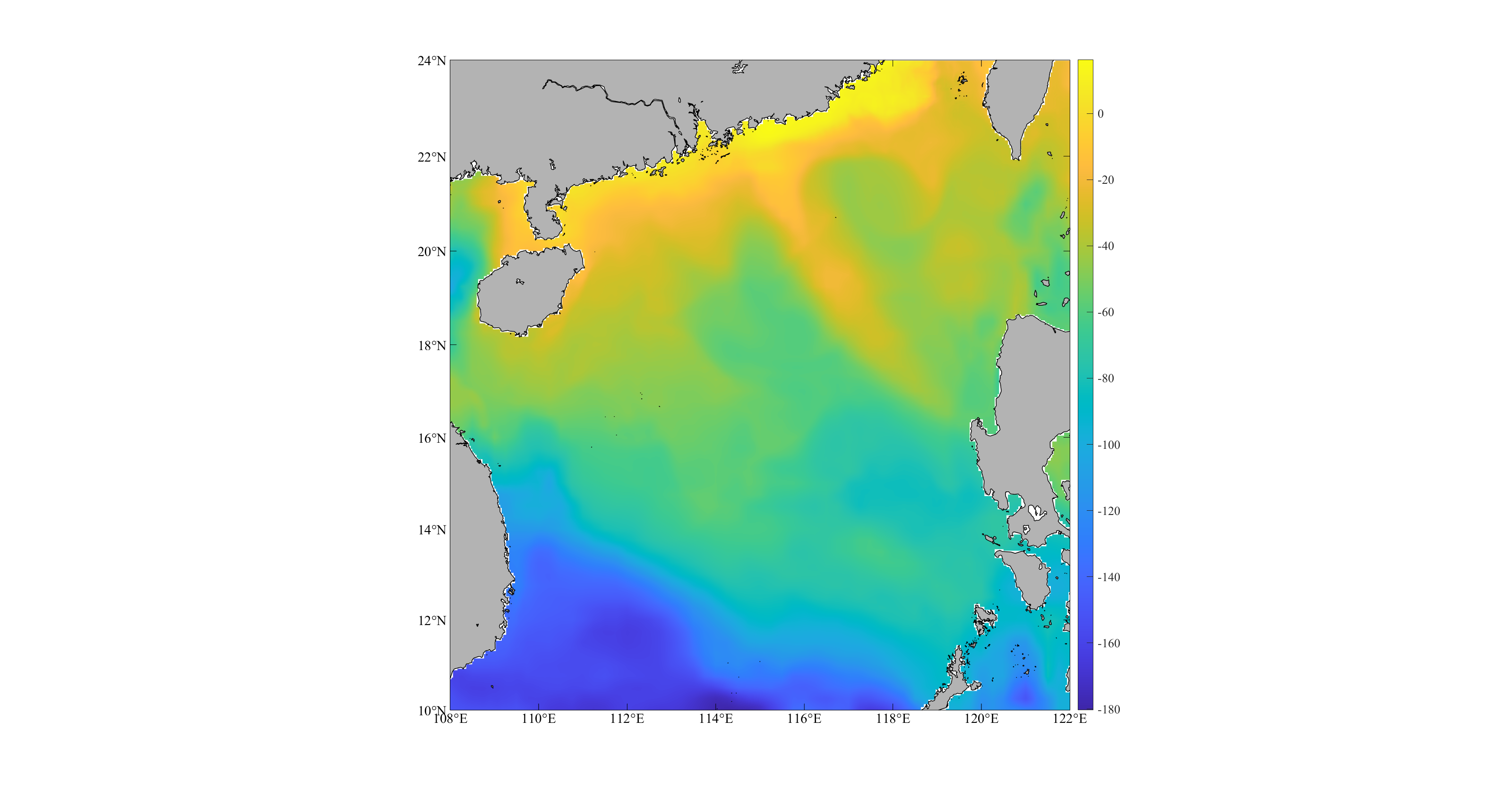

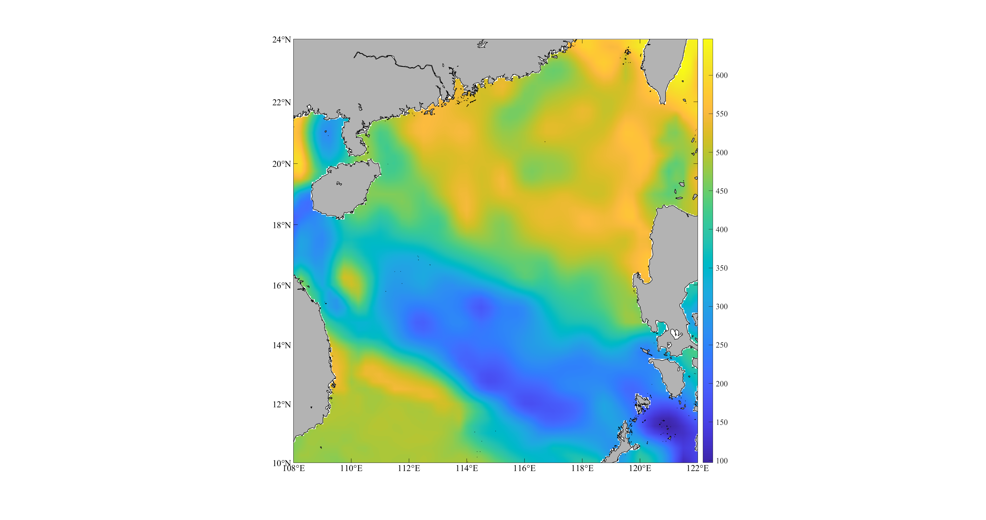

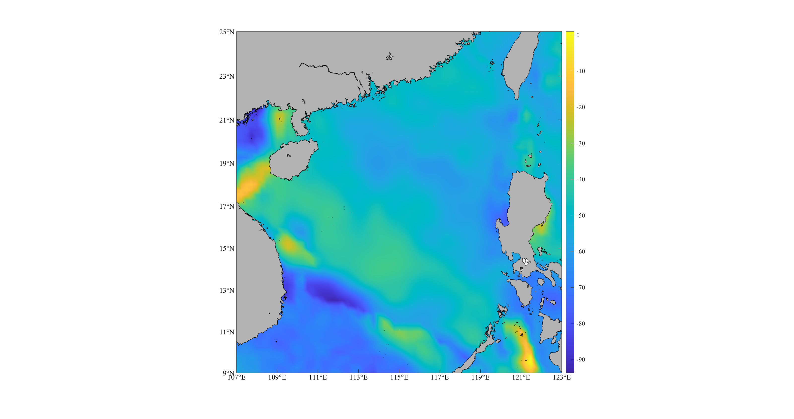

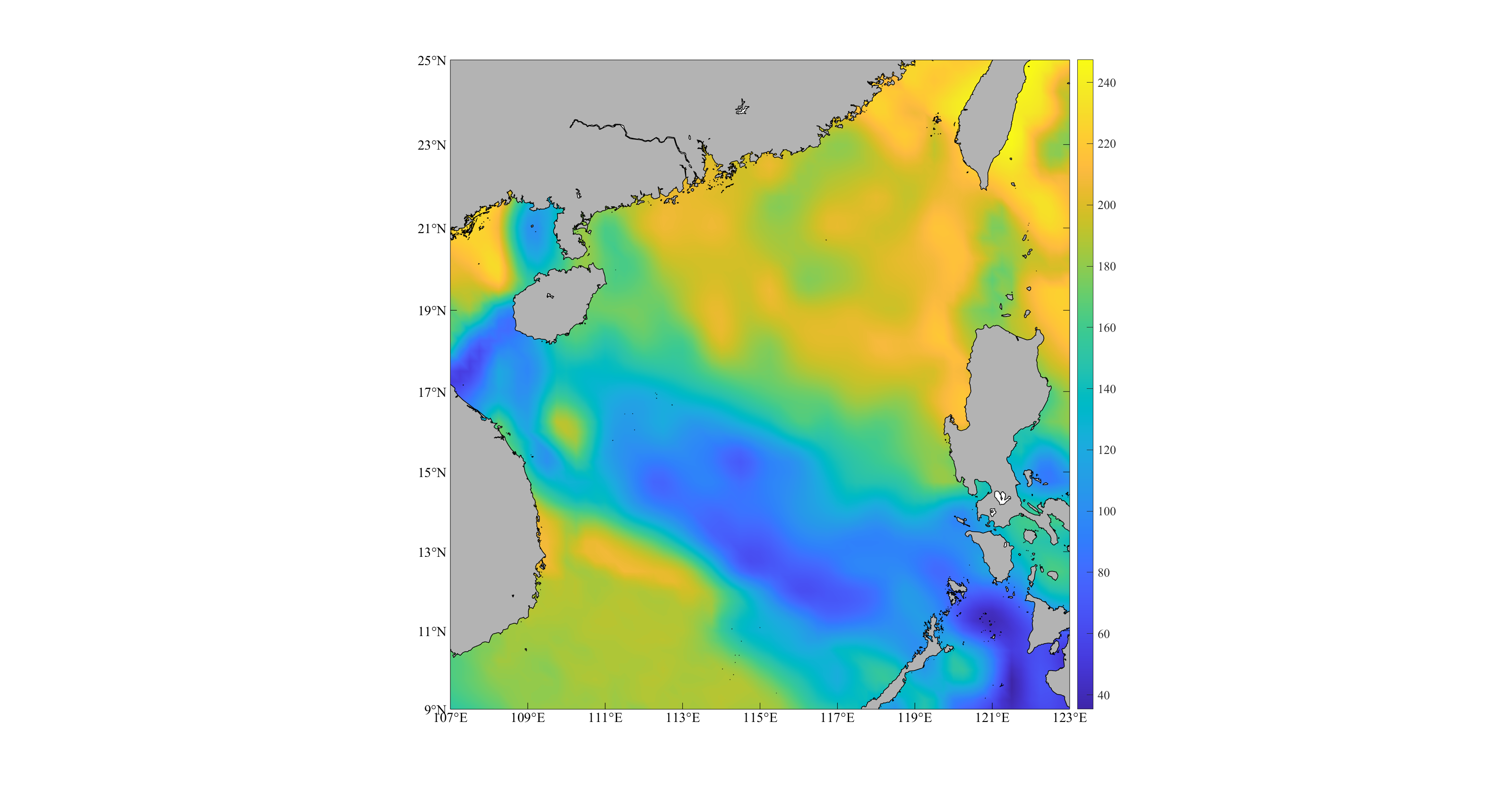

I am a beginner in roms, and the temperature deviation in the simulation results is very large. Comparing the results of the thermal radiation flux input by forcing_file and the thermal radiation flux output by roms, it is found that there are large deviations in each heat flux. The swrad output by roms is about three times that of the swrad input by forcing_file, and the lwrad output by roms is also much larger than the lwrad input by forcing_file, but the spatial distribution has almost no relationship. Wonder what the cause of this problem is (forcing_file's data source is REA5) The time resolution of the forced field file is 1 hour。
Note: The absolute value of lwrad output by ROMs is larger than that of lwrad input by forcing_file
Thank you very much!

Average daily data of the first day of swrad output by roms
Average daily data of the first day of swrad output by forcing_file
Average daily data of the first day of lwrad output by roms
Average daily data of the first day of lwrad output by forcing_file
wenpuho
Posts: 3
Joined: Thu Dec 16, 2021 9:37 pm
Location: National Central University
Re: The simulation temperature is too high, and the output swrad and lwrad of the roms are too large
#2 Unread post by wenpuho »
Nonlinear/bulk_flux.F would calculate longwave when #LONGWAVE or #LONGWAVE_OUT is defined; otherwise, you should provide longwave radiation flux (lwrad) in netcdf input.
For shortwave radiation flux, you need to provide it when define #SHORTWAVE (see Include/globaldef.h to check the condition requiring #SHORTWAVE) and there are two possible ways to provide it: 1. define #ANA_SRFLUX, roms would calculate srflx in ana_srflux subroutine, and the dependent surface variables would be according to which option is defined: #ALBEDO, #DIURNAL_SRFLUX, or nothing. Note that in this case you may or may not need the sward as input. 2. sward directly in the netcdf input without the above options.
That's why your output swrad feature was similar to the input (#DIURNAL_SRFLUX was defined, a function of lon, lat and day) and output lwrad was totally different (calculated by bulk_flux.F)
wanghaoyu
Posts: 16
Joined: Thu Sep 15, 2022 7:57 pm
Location: iocas
#3 Unread post by wanghaoyu »
Thank you very much for your reply. Just as you said, the output swrad is three times that of the forced field input swrad, because I have defined #DIURNAL_SRFLUX, but I still have a question about what operations swrad will undergo after roms defines DIURNAL_SRFLUX. What are the characteristics of the calculated temp (what is the difference from not defining #DIURNAL_SRFLUX)
