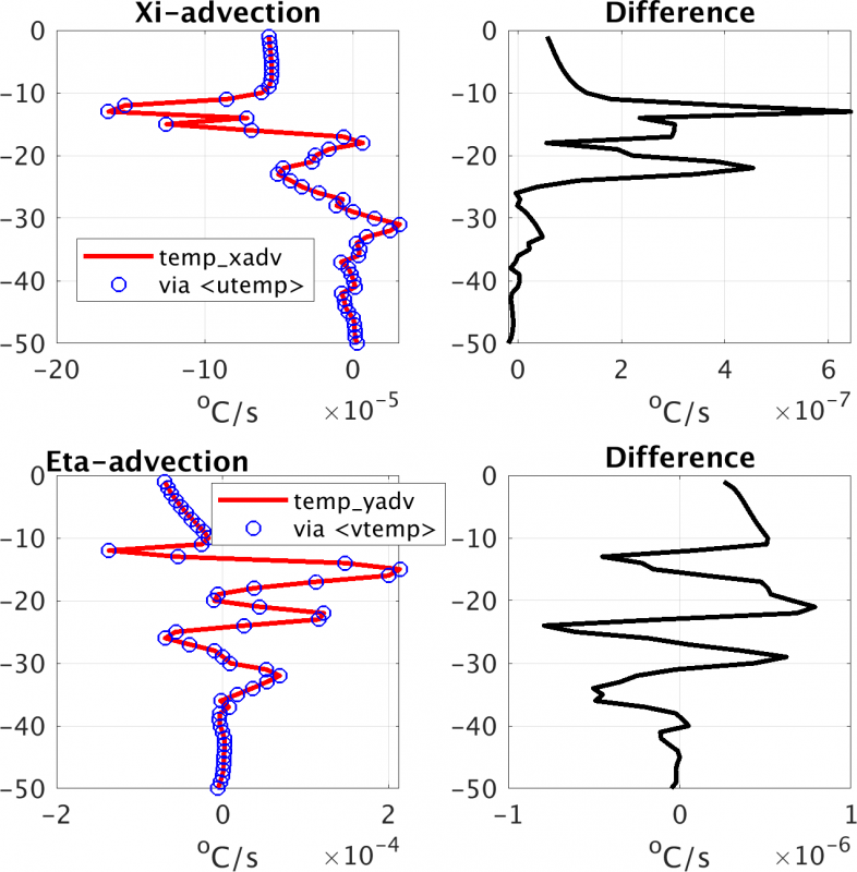

My understanding is the advection terms in the averaged files are written out as convergence of the fluxes, i.e., -d(uT)/dx, -d(vT)/dy, etc. I am trying to compare the time-averaged horizontal advection of temperature estimated two ways
1. The values written out in 'temp_xadv' and 'temp_yadv' in the diagnostic files.
2. Estimate the advection terms by finite-differencing 'utemp' and 'vtemp' (time-averaged quadratic terms), written out in the averaged files. If I want to compare with temp_xadv(i,j), I just take 'utemp' at the two adjoining cell faces and multiply with pm(i,j). Similarly for the 'vtemp' term but with pn(i,j).
I am attaching a plot showing how they compare. The y-axis is not the depth but is simply the array [-50:-1] such that -50 corresponds to the ocean bottom. The model has 50 vertical levels. The two panels in the left column show the two methods agree reasonably well. The panels on the right show the difference (red minus blue) between the two estimates. The difference is about two orders of magnitude smaller than the actual terms.
My questions:
(i) Why is there any difference at all? Shouldn't they be identical?
(ii) The difference plot shows the 'utemp' estimate underestimates 'temp_xadv' at all depths but the corresponding difference for eta-advection assumes both positive and negative values. Any particular reason for this trend?

No, these things won't be exactly the same.
The _xadv and _yadv terms (and their divergence which is already saved for you in the companion _hadv diagnostics) are the fluxes through the faces (time averaged) exactly as ROMS computed them according to the selected advection scheme. In the case of the high order Akima and weighted-upwind schemes, these fluxes are computed over a 3 or 4 grid cell stencil so their divergence is not a simple difference of the u*temp terms on the faces of a single cell.
Moreover, the ROMS time varying vertical s-coordinate means that the cell thickness, H, and hence cell face area itself (H/n) varies with time on every time step. Thus the time average <u*temp> multiplied by the time average layer area <H/n> is not exactly equal to <H/n*u*temp> because the triple nonlinearity of the perturbations <H'u'temp'> is not zero.
But to assist in detailed term balance calculations ROMS offers the option to save these cell area weighted "quadratic" terms. Look for the line
Aout(iHUTav) == F F     ! Huon_temp, ...     tracer volume flux, <Huon*t>
in the roms.in file. When working with these terms they are already multiplied by the cell width and thickness, hence the units noted in varinfo.dat that carry over to the output.
'Huontracer'                                       ! Output
  'time-averaged tracer u-volume flux'
  'meter3 second-1 tracer'                         ! [m3/s tracer]
