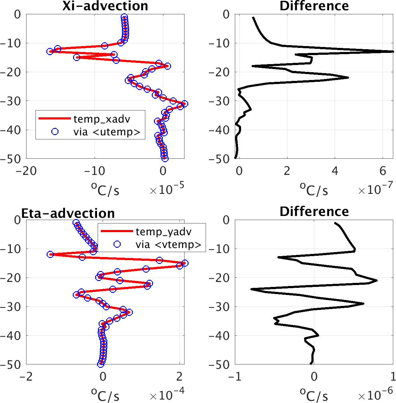

I am attaching a plot showing how they compare. The y-axis is not the depth but is simply the array [-50:-1] such that -50 corresponds to the ocean bottom. The model has 50 vertical levels. The two panels in the left column show the two methods agree reasonably well. The panels on the right show the difference (red minus blue) between the two estimates. The difference is about two orders of magnitude smaller than the actual terms.

(i) Why is there any difference at all? Shouldn't they be identical?
(ii) The difference plot shows the 'utemp' estimate underestimates 'temp_xadv' at all depths but the corresponding difference for eta-advection assumes both positive and negative values. Any particular reason for this trend?

No, these things won't be exactly the same.
The _xadv and _yadv terms (and their divergence which is already saved for you in the companion _hadv diagnostics) are the fluxes through the faces (time averaged) exactly as ROMS computed them according to the selected advection scheme. In the case of the high order Akima and weighted-upwind schemes, these fluxes are computed over a 3 or 4 grid cell stencil so their divergence is not a simple difference of the u*temp terms on the faces of a single cell.
Moreover, the ROMS time varying vertical s-coordinate means that the cell thickness, H, and hence cell face area itself (H/n) varies with time on every time step. Thus the time average <u*temp> multiplied by the time average layer area <H/n> is not exactly equal to <H/n*u*temp> because the triple nonlinearity of the perturbations <H'u'temp'> is not zero.
