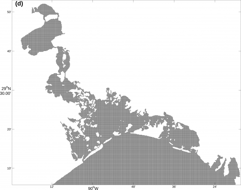

My Domain: Curvilinear grid with 542 grids in x direction, and 437 grids in y direction. There are many land points in my domain (see the white area in the first attached figure).

SWAN tiles its domain by dividing the longest edge into the number of cores. So your longest edge is 542 and that happpens to be in the x-dir, divide by 30 gives around 18. so each tile is 18x437.
for coawst i need to have the tiles be square, so that we can combine them with roms grid to determine the mct exchanges.
for swan from the swan site, it will remove the dry cells and be able to use more processors, but in coawst i dont allow this in order to keep the grid rectangular.
another issue is that each tile needs to have at least one computationally active cell. it looks like the first 18 or so columns on the left are all land. So when you use (lets say) 40 cores, the tiles will be 9x437 and the first 9 columns are all land and swan will not like that.

in the mean time, is there a reason why the grid has all that land on the left side? what if you started the grid around 90 - 18 W?

jcwarner wrote: Sun Mar 29, 2020 7:28 pm SWAN tiles its domain by dividing the longest edge into the number of cores. So your longest edge is 542 and that happpens to be in the x-dir, divide by 30 gives around 18. so each tile is 18x437.
so...
i thought we had fixed part of this so that a swan tile could be all land, but perhaps not. i can look into that again.
Thanks Dr. Wanner!
Well, if this problem cann't not be solved right now in term of the codes, I think I may need to rotate my SWAN grid a little bit to have less lank cells. I am running a ROMS and SWAN coupled case with 30 cores for SWAN and 400 cores for ROMS. The speed seems to be accetable. But, we'll see if the SWAN grid rotation is needed for a faster computation.
