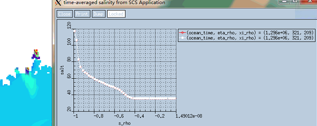

But in avg.nc file, at mouth of river, the bottom salinity is very high, more than 100!
Absolutely , my model has blew up. But I don't know whats wrong with me.

- this picture shows bottom salinity,and the curve shows salinity changing with s_rho.
- QQ图片20180802231056.png (58.99 KiB) Viewed 21587 times
