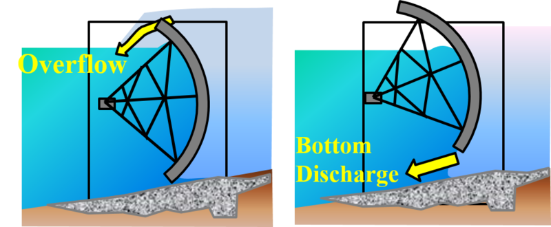

I think I need to explain more about my study site.
My estuary has a radial type gate(You can see attached picture).
During dry season, the dam is closed. But it makes excess water overflow from surface.
During flood season, the dam is opened from bottom.
I wanna run my model for a year and dry/flood season is repeated (usually summer is flood season, winter is dry season)
That's why I wanna use different vshape in a model.

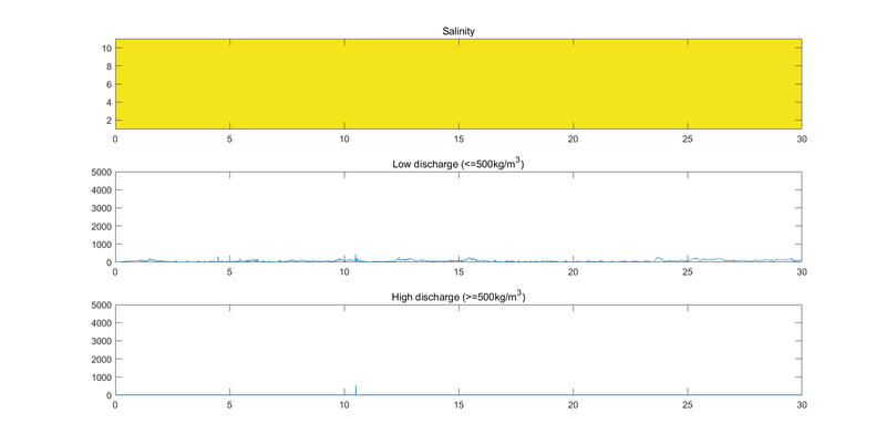

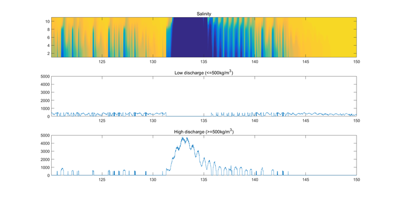

I tried to use different vshape in a river_input file
The result shows in the attached file.....
(top: contour of salinity, mid : mass transport of low discharge, bottom : mass transport of high discharge/xaxis:days)
I think only high discharge is read in the model.
As I told previous topic, I set
river=[1 2 3 4 5 6 7 8 9 10]
Xposition=[113 113 113 113 113 113 113 113 113 113]
Eposition=[123 124 125 126 127 123 124 125 126 127]
the first 5 indices mean low discharge case which has overflow
the last 5 indices mean high discharge case which contain discharge from bottom.
Because of same location of river, The last 5 rivers replace the first 5 rivers
(I think That's why the model only show the high discharge)
Is there any way to the model can read two river file like forcing file?
than I can divide a river file into two river_file which has different vshape
-Jongwi

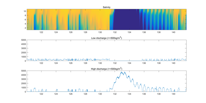

I run the model with changed step3d_uv.F
1. I add USE mod_scalars for tdays
SUBROUTINE step3d_uv (ng, tile)
USE mod_param
USE mod_coupling
USE mod_scalars
2. I declare ismin and ismax as integer
! Local variable declarations.
integer :: i, idiag, is, j, k, ismin, ismax
real(r8) :: cff, cff1, cff2
real(r8), dimension(IminS:ImaxS,0:N(ng)) :: AK
real(r8), dimension(IminS:ImaxS,0:N(ng)) :: BC
real(r8), dimension(IminS:ImaxS,0:N(ng)) :: CF
real(r8), dimension(IminS:ImaxS,0:N(ng)) :: DC
real(r8), dimension(IminS:ImaxS,0:N(ng)) :: FC
3. Finally I change some part of code like this
#ifdef HACK_RIVER_VSHAPE
IF (tdays(ng).le.140_r8.and.tdays(ng).ge.130) THEN
ismin=6
ismax=10
ELSEIF (tdays(ng).le.260.and.tdays(ng).ge.175) THEN
ismin=6
ismax=10
ELSE
ismin=1
ismax=5
ENDIF
Do is=ismin,ismax
write(*,*) 'is=', is
#else
DO is=1,Nsrc(ng)
i=SOURCES(ng)%Isrc(is)
j=SOURCES(ng)%Jsrc(is)
So the log-file shows that the model read ismin/ismax/is correctly.
But the results didn't change with previous run......
Is there any possibility that I make wrong river_input?
Could you check my river input which is attached in this post?
(the tracers aren't included in this file because of file size)
I'm sorry to a lot of question....Thank you!
-Jongwi

If you search the code for other occurrences of LuvSrc you'll find it also in step2d_LF_AM3.h. Looks you need to hack the barotropic velocity also at line 2438 in step2d_LF_AM3.h.
There is also code in step3d_t.F but unless you have different salinity and temperature in conjunction with the discharge change, that is probably of no consequence.
