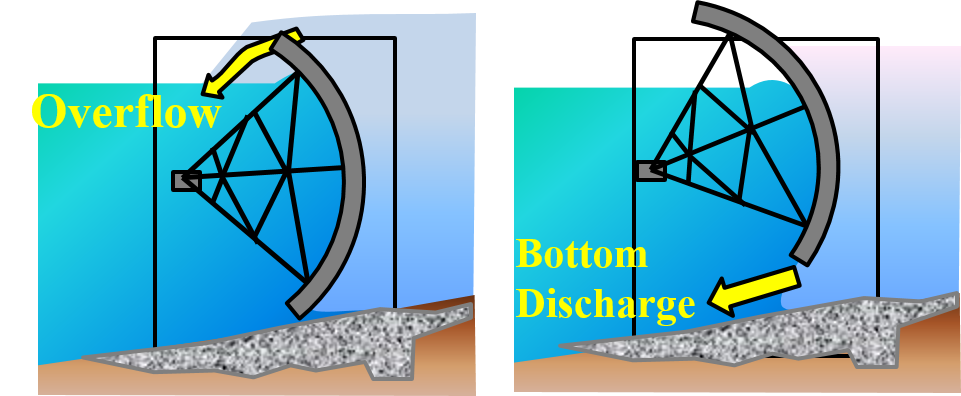

I think I need to explain more about my study site.
My estuary has a radial type gate(You can see attached picture).
During dry season, the dam is closed. But it makes excess water overflow from surface.
During flood season, the dam is opened from bottom.
I wanna run my model for a year and dry/flood season is repeated (usually summer is flood season, winter is dry season)
That's why I wanna use different vshape in a model.
if I set a river_input like
river=[1 2 3 4 5 6 7 8 9 10]
Xposition=[113 113 113 113 113 113 113 113 113 113]
Eposition=[123 124 125 126 127 123 124 125 126 127]
and different river_vshape for each river index, Do you think does it work like what I want?
Thanks again

Re: river discharge river_Vshape or Multiple rive file
Huh, didn't think of that. It might work, worth trying it!

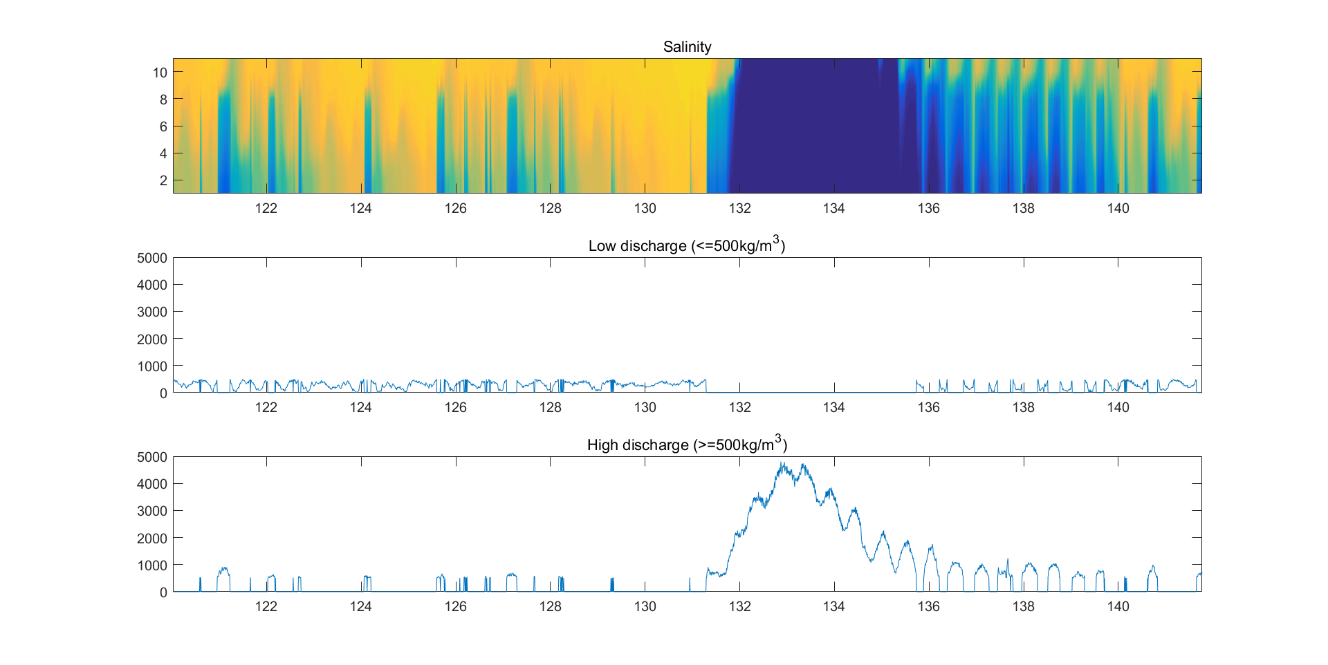

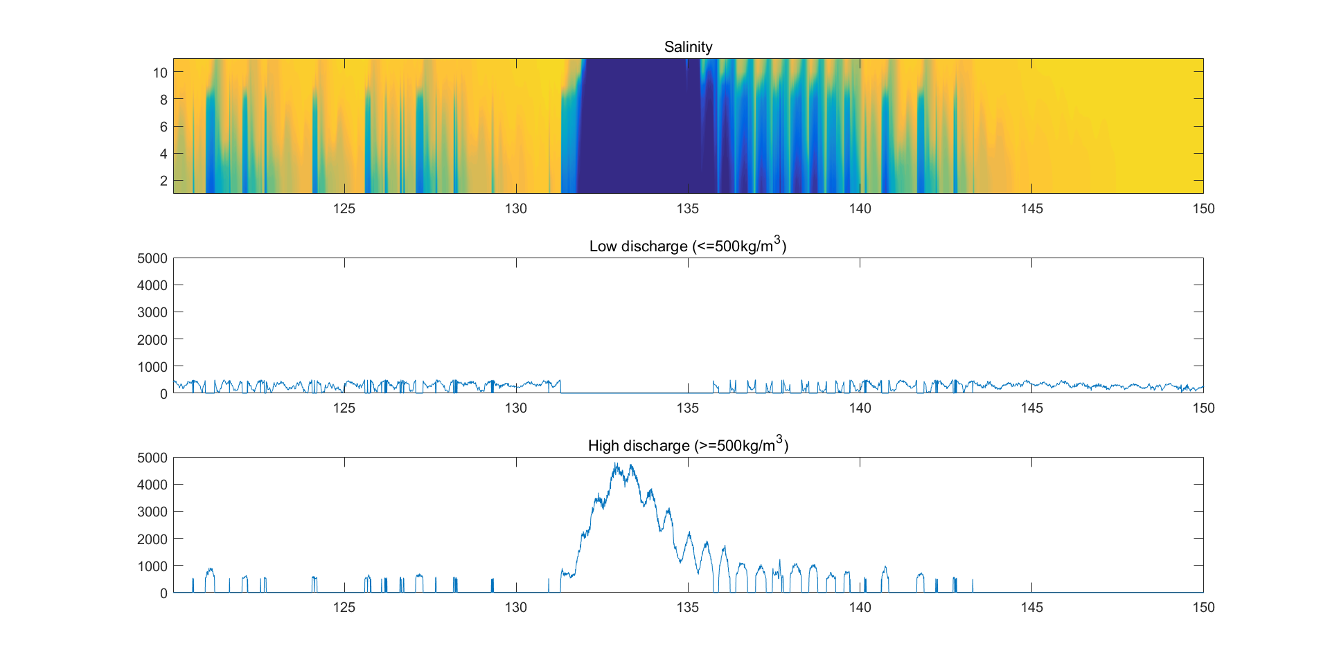

Hi-
I tried to use different vshape in a river_input file
The result shows in the attached file.....
(top: contour of salinity, mid : mass transport of low discharge, bottom : mass transport of high discharge/xaxis:days)
I think only high discharge is read in the model.
As I told previous topic, I set
the first 5 indices mean low discharge case which has overflow
the last 5 indices mean high discharge case which contain discharge from bottom.
Because of same location of river, The last 5 rivers replace the first 5 rivers
(I think That's why the model only show the high discharge)
Is there any way to the model can read two river file like forcing file?
than I can divide a river file into two river_file which has different vshape
-Jongwi
Yes, your problem is in step3d_uv.F, where if you look at the code around line 967 ...Because of same location of river, The last 5 rivers replace the first 5 rivers
! Apply momentum transport point sources (like river runoff), if any.
IF (LuvSrc(ng)) THEN
DO is=1,Nsrc(ng)
i=SOURCES(ng)%Isrc(is)
j=SOURCES(ng)%Jsrc(is)
u(i,j,k,nnew)=SOURCES(ng)%Qsrc(is,k)*cff1
