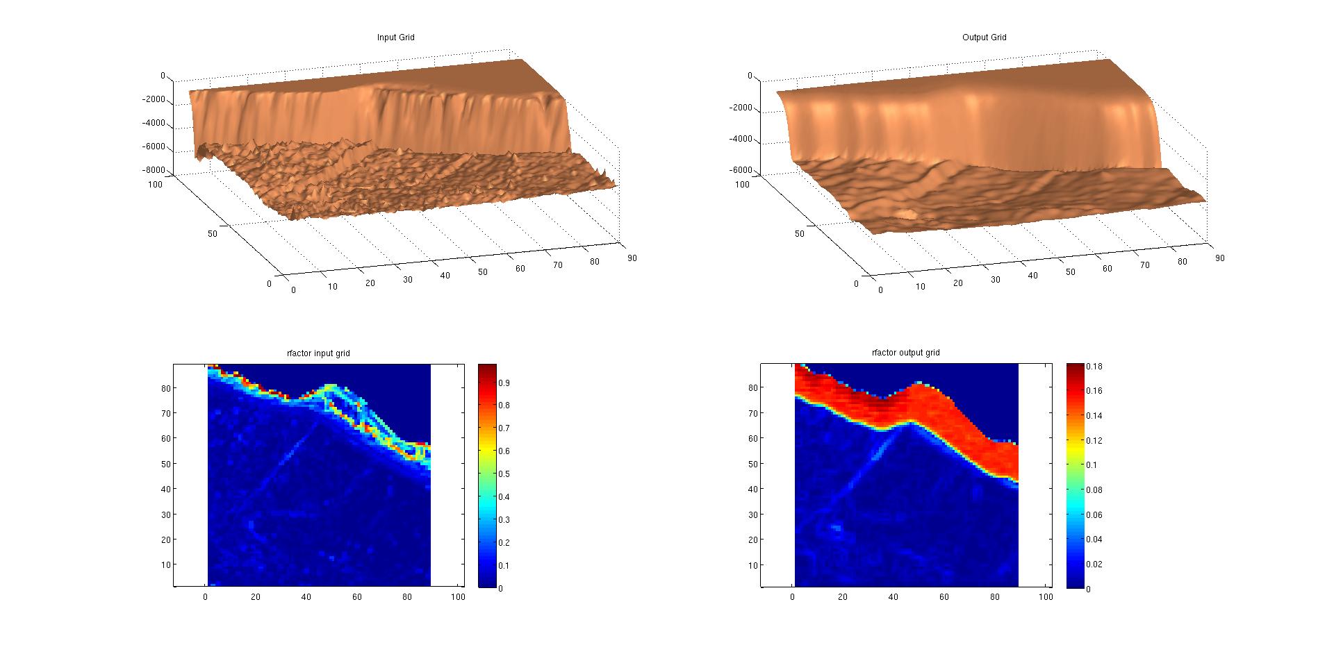

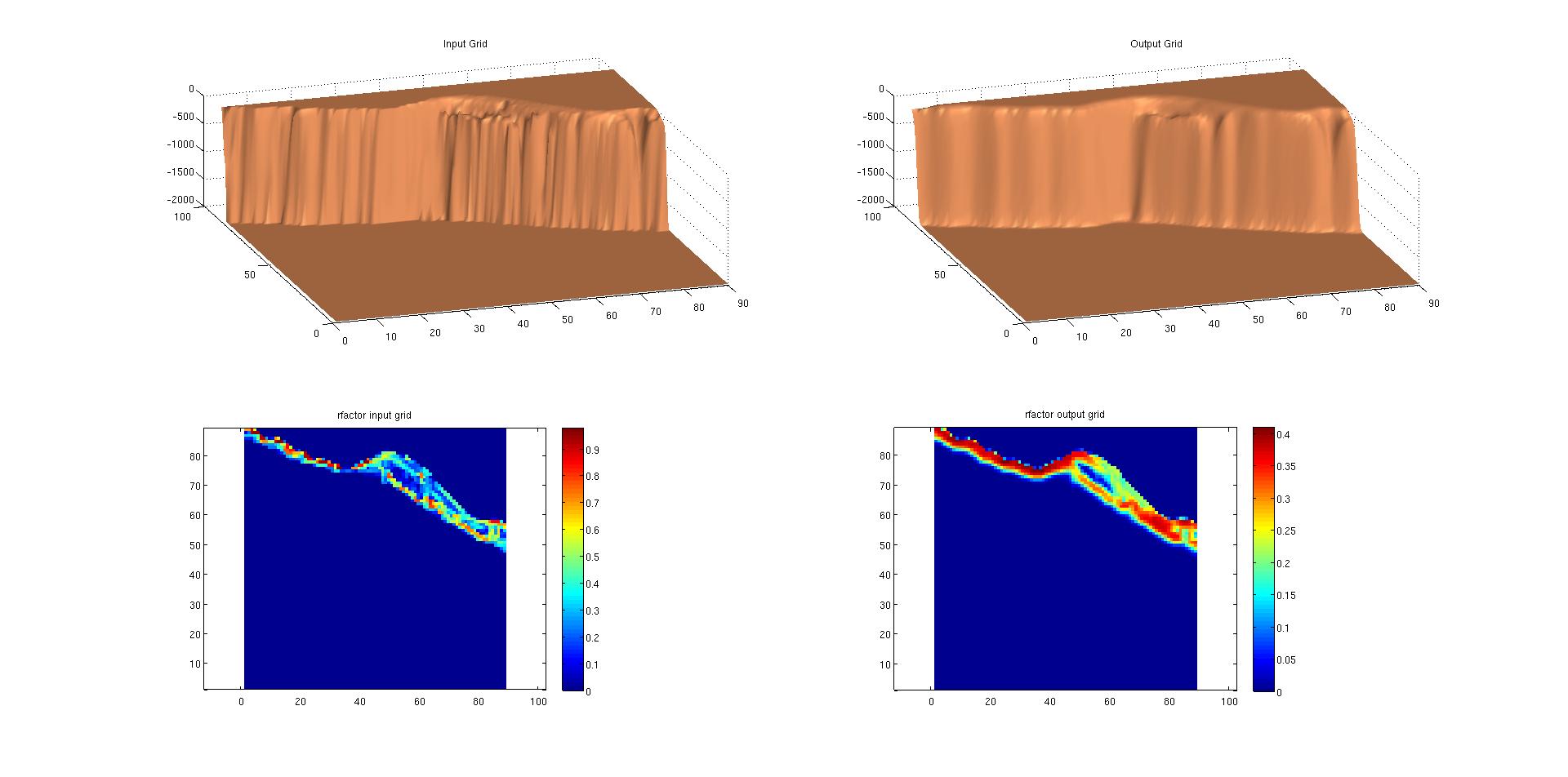

Hi!
Many thanks to both for your help.
I had smoothing the grid ... step by step to the extent that I smoothing at 2000m deep, because I only have interesting in the first 200 m of the surface, but I still have the same problem ...
My Beckmann value still been 9.943090e-1 although the grid is so smoothing

Scarlett
Posts: 48
Joined: Tue Aug 04, 2015 4:42 pm
Location: Universidad del Mar (UMAR), Mexico
Re: Blowing-up: Saving latest model state into RESTART file
#6 Unread post by Scarlett »
Hi Kate:
So many thanks for your help, it was so useful, it run at 20 m deep!
I've been doing some sensitive test, and It's run at 180m maximum deep. But, What would happen if I want to considered a realistic bathymetry?How can I avoid this inconsistency, without smoothing so much the bathymetry? What do I need to considered?
I want to use 500 m deep
I'm working with:
r=0.5
n_filter_deep_topo=2
n_filter_final=2
theta_s=5
theta_b=.4
Tcline=10
N=32
Vtransform == 2
Vstretching == 4
Could you help me? Annex figure with real bathymetry
Thanks in advance.
Mar.Mo.
#7 Unread post by kate »
Did you change the boundary conditions?
The way to model a steeper bathymetry is more horizontal resolution. With bathymetry smoothing there are trade-offs between realistic geometry and good model behavior. You just have to think about what you are resolving and what you need to resolve to get the answers you want. Plus try it and see.
