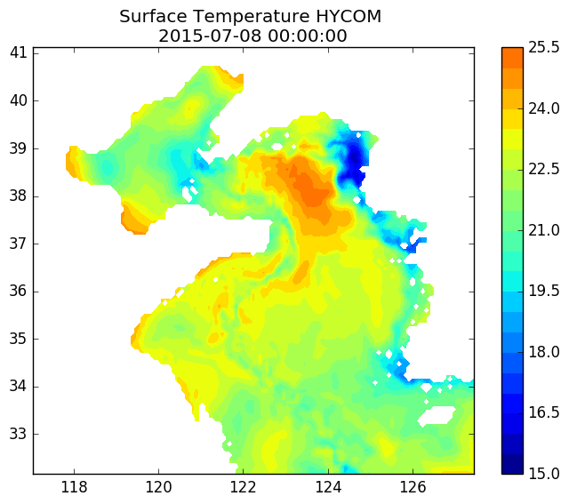

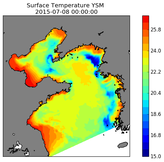

By compare with the HYCOM file and our measurement, the model was overheated a lot in summer near the coast. And also the vertical temperature profile was not realistic compare to our observation.
The comparison of the surface temperature is shown in the figure below.

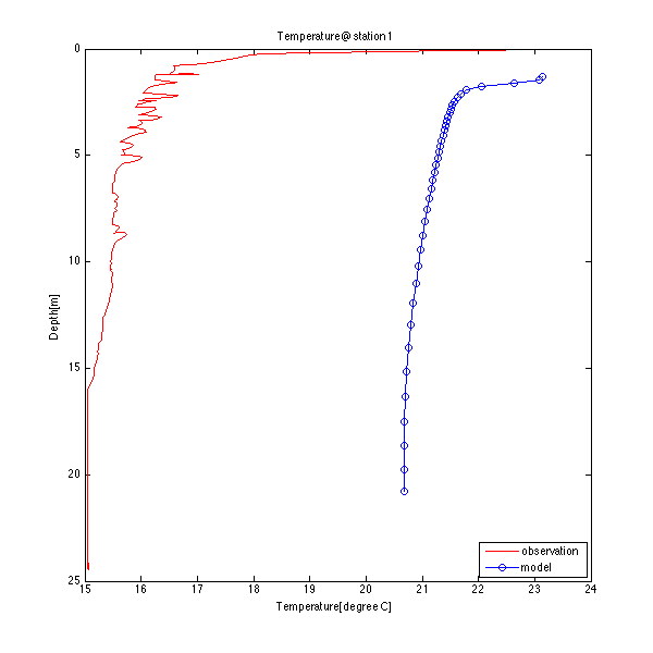

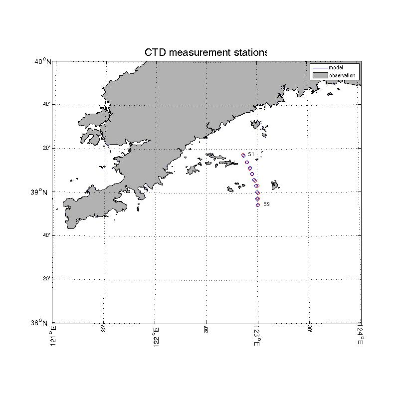

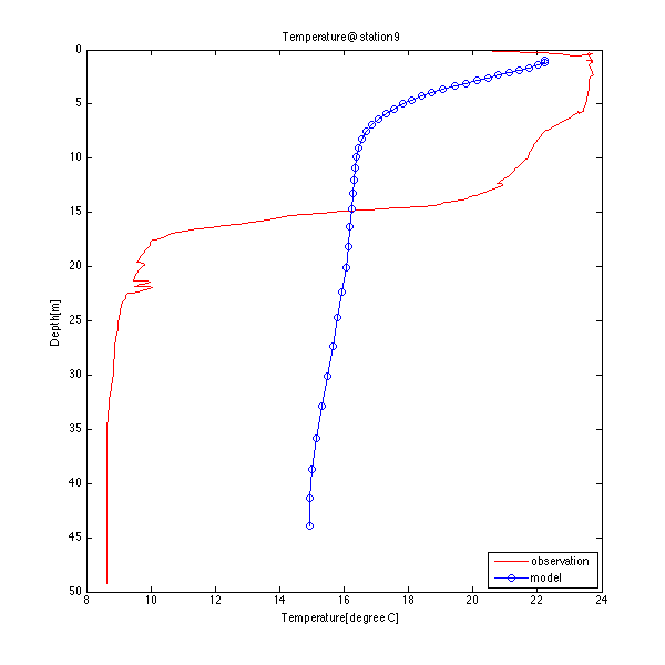

We also have some CTD measurement near the coast and the stations and result for station 1 and station 9 was shown below as well. the coastal water is being overheated a lot and there seem to be too much vertical mixing.
CTD stations.jpg (59.58 KiB) Viewed 4053 times
I wonder whether the low resolution of the radiations would be a reason why the coastal water is being overheated. If we use the 3-hourly forcast value there would be some improvement?
Our measurement was taken in July, and the region should be in the tidal mixing front in the Yellowsea, it seemed that the model did not perform very well in this region with the MY2.5 scheme. Are there any suggestions or experience for setup models in similar places?
