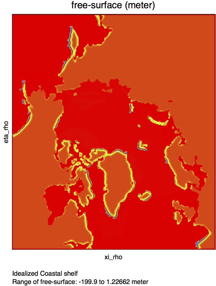

I have encountered constant crashing of a ROMS-CICE-WRF coupled model. Interestingly, the model crashes at exactly 10 baroclinic (3D) time steps, no matter how long the time step size is (of coz, within the CFL bound). The time step varies from 240s to 1200s, 1800s and 3600s (with the barotropic step set to 40s for 3600s baroclinic time step to ensure stability).
From 1st to 9th step, the model seems to run without any problem, but on the 10th step, the potential energy witnessed a burst to NaN, but there is no hint what went wrong before the last step (shown in the logs).
I do have WET_DRY enabled in the macros (shown below).
The zeta is obviously too big in the negative direction (-199 m) at certain continental boundaries, but I don't know what has caused it.
The macros and the log is shown below.
Thanks for any suggestions of what might be going wrong with it :)

Zeta in the final dumped snapshot (restart) file/state is attached.

 ## ROMS grid  1  sent data to WRF grid  1
      WRT_HIS   - wrote history  fields (Index=2,2) into time record = 0000008
      8     0 08:00:00  1.684789E-03  1.747108E+04  1.747108E+04  4.924654E+16
          (107,127,40)  6.173031E-03  2.756786E-02  1.689588E+01  2.685525E+00
 ## ROMS grid  1 recv data from WRF grid  1
      WRT_HIS   - wrote history  fields (Index=1,1) into time record = 0000009
      9     0 09:00:00  1.688831E-03  1.747094E+04  1.747094E+04  4.924664E+16
          (107,127,40)  2.407506E-03  1.043648E-02  1.595644E+01  3.744220E+00
      WRT_HIS   - wrote history  fields (Index=2,2) into time record = 0000010
     10     0 10:00:00  1.681953E-03           NaN           NaN  4.924684E+16
          (150,201,40)  1.269356E-01  1.950973E-02  1.188577E+01  3.961068E+00
 Blowing-up: Saving latest model state into  RESTART file
      WRT_RST   - wrote re-start fields (Index=1,1) into time record = 0000001
 Elapsed CPU time (seconds):
 Node   #  0 CPU:     302.568
 ROMS/TOMS - Output NetCDF summary for Grid 01:
             number of time records written in HISTORY file = 00000010
             number of time records written in RESTART file = 00000001
 Analytical header files used:
     ROMS/Functionals/ana_btflux.h
     ROMS/Functionals/ana_stflux.h
Zeta in the final snapshot. Note that the large negative values on the continental boundaries.
susonic
