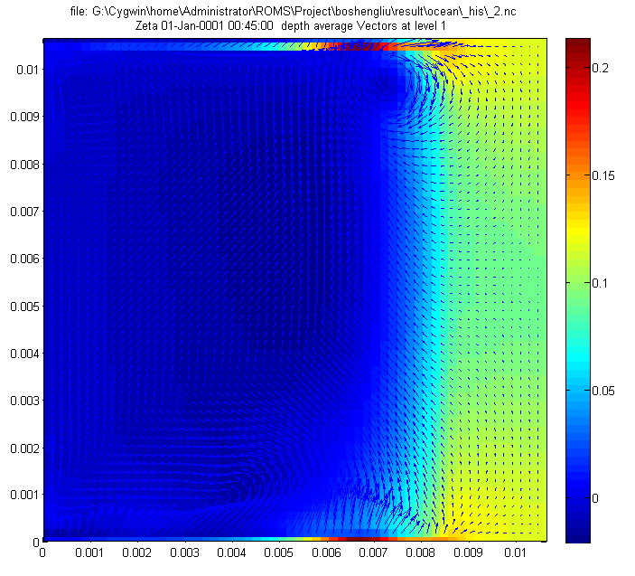

You are right ! I set wrong 'grd' parameter in roms_sview.m. My grid is generated by easygrid. ocean_his_2.nc is my result file ,boshengliu_grd.nc is my grid file.
I set grd=roms_get_grid('ocean_his_2.nc','ocean_his_2.nc') before . grd.lon_u and grd.lon_rho all values are 0 .So it's wrong to use roms_sview to plot vectors.
If I set grd=roms_get_grid('boshengliu_grd.nc'), roms_sview will work well . I can get the velocity vectors.
But I still have two questions . First ,how to change the vector color ? The color
is blue .I want to set it black . What should I do ? Second ,if i want to plot vectoes from (ubar,vbar) ,should i just set var='ubarmag' ?
Thank you !
