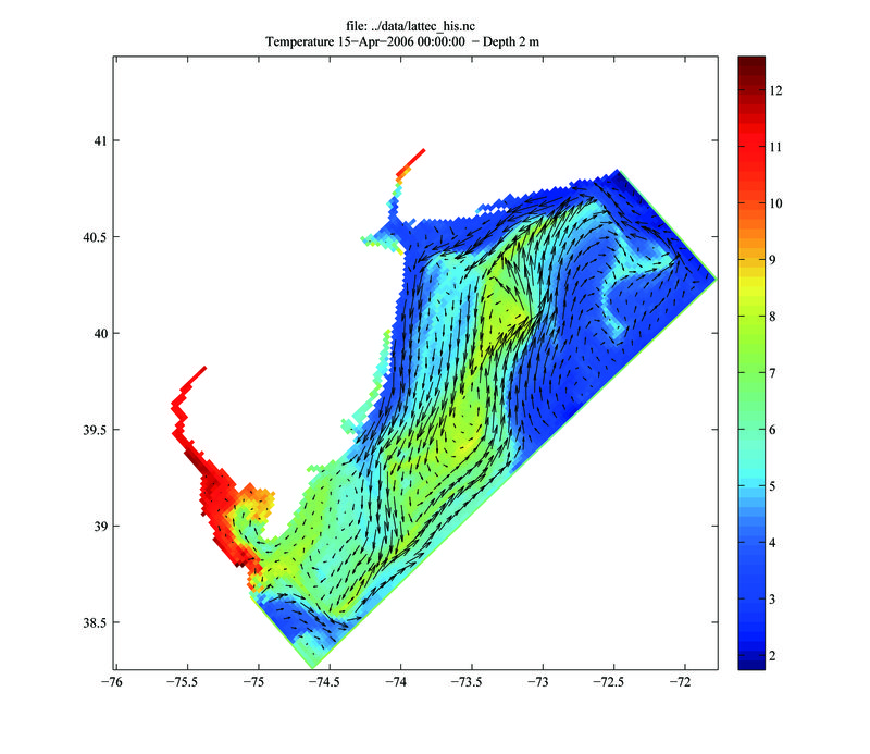

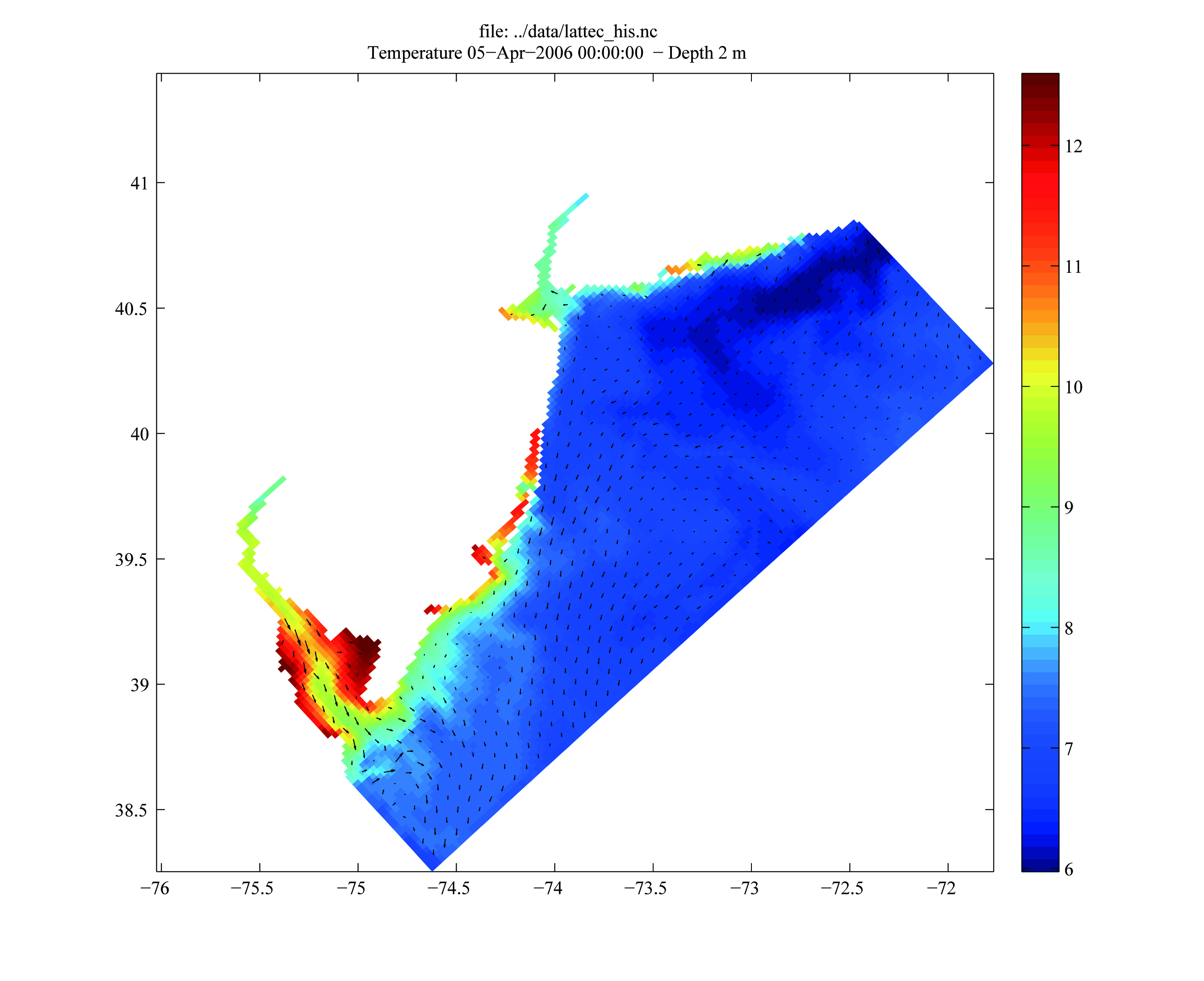

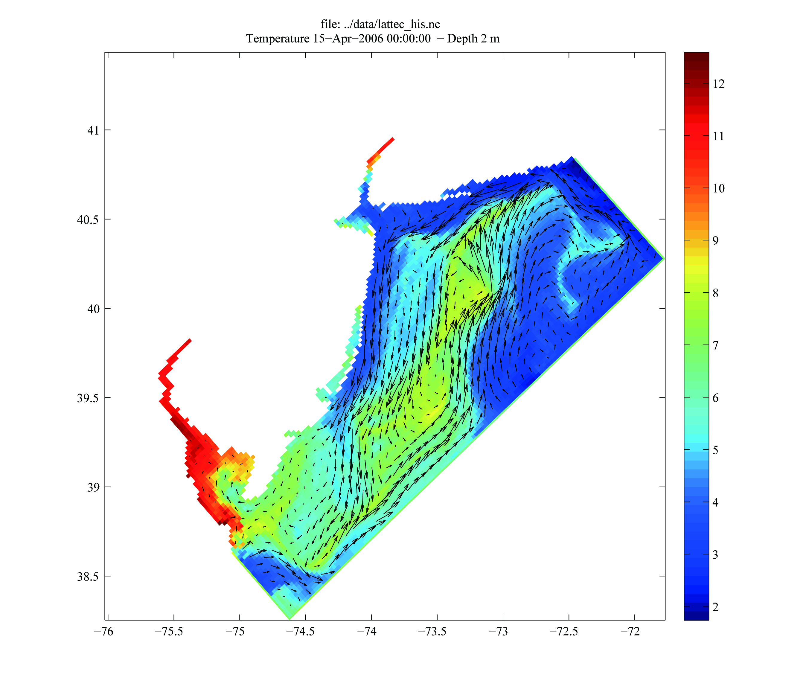

there is good news.
I successfully carried out the LATTE case. some figures are in the attachment. you can have a look.
BTW, the Varinfo.dat file is also given, and other files can be found in
http://coast-enviro.er.usgs.gov/models/Latte/
and the instruction is in https://www.myroms.org/wiki/index.php/CSTMS_UNSW2008
If you have any questions, just leave yr words here.
Cheer up
zhao
