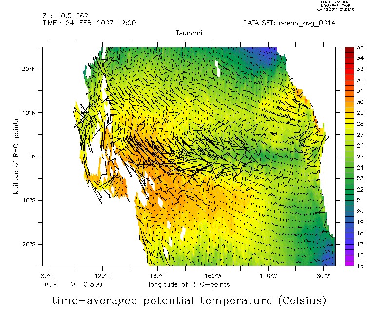

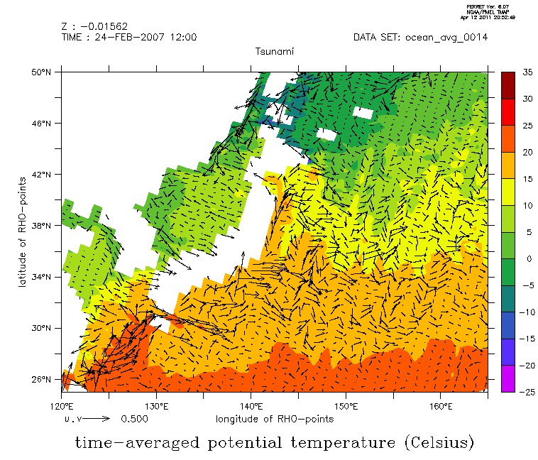

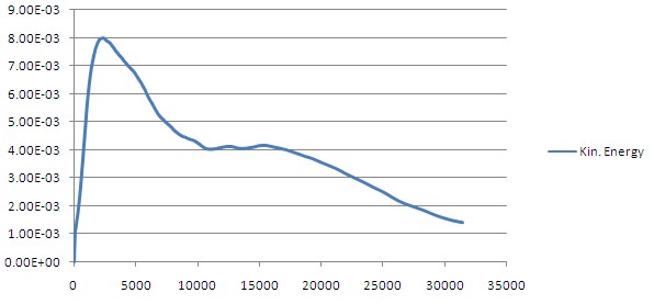

After one-year-running, the kinetic energy shows a trend to be less and less.
And the flow field is strange. The Kuroshio is not visible.
So as the tropical region:
Any suggestion or help is appreciated!
