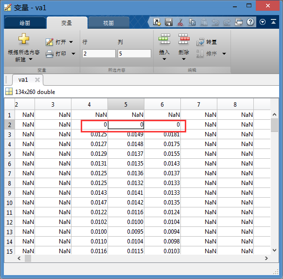

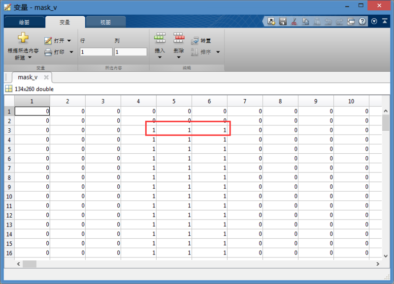

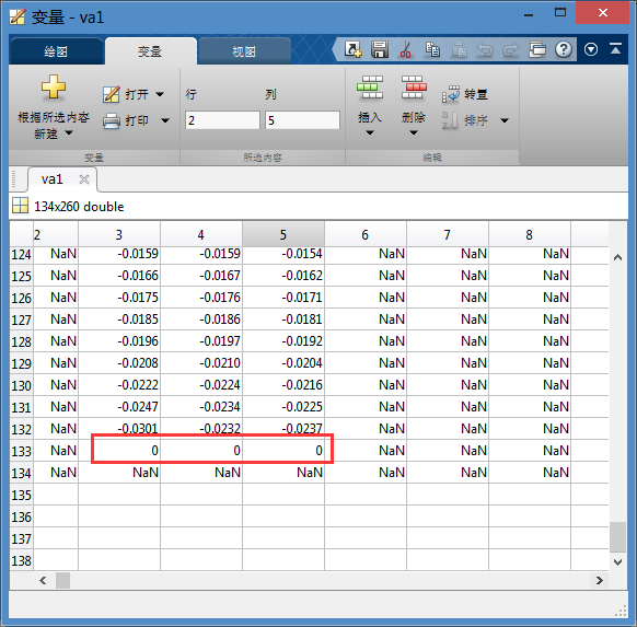

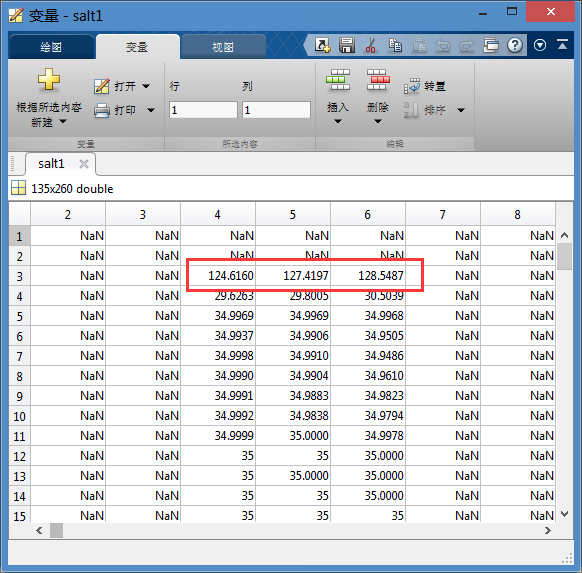

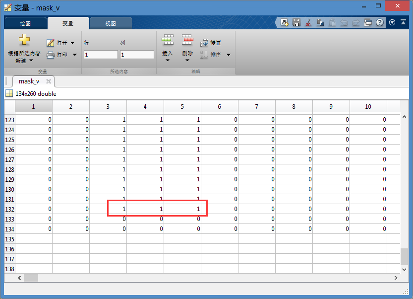

The files I attached are the river points in the mask_v from my grid file.The river points in the mask_v of the north to south river are (4,3)(5,3)(6,3),so the real river points I should get for the roms running are (3,3)(4,3)(5,3).
So as to the south to north river.The river points in the mask_v are (3,132)(4,132)(5,132),so the real river points I should get for the roms running are (2,132)(3,132)(4,132).Am I right?
When I set these river points in my make_forcing_river.m file,and the result of the roms runnning are strange.the salt value in the river points are all larger than 128.Both rivers have this case.
However,if i set the river points in (3,2)(4,2)(5,2),and (2,133)(3,133)(4,133)(these points are all land points),the salt value seems regular.but the velocity in the river points are all zero.
Waiting for your responses.Thanks. :oops:

As I said back in March 2011, it depends on how you do your counting. Assuming you are counting in the Matlab/Python/ncview way, the indices of the v-points should match those of the rho-points for the north-to-south rivers and should be one less in j from the rho-points for the south-to-north rivers. In both cases, the i-indices should match those of the rho-points.
Are you providing tracer values on inflow? If not, you are facing the dread down-stream advection scheme, known to be unstable.
