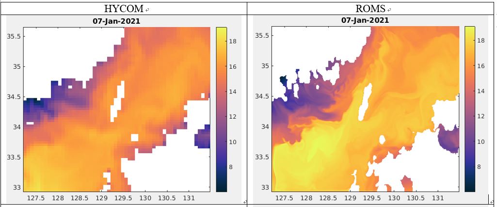

Dear ROMS Community,
When I constructed the initial and lateral boundary conditions for the model, HYCOM data were interpolated (hot start).
However, the surface temperature of the model was more than 4 degrees Celsius higher than HYCOM after only 5 days of simulation.
I tried turning off all the forcing files (Qair, Pair, Tair, winds, etc.) to find out why the surface temperature was increasing (I actually turned off bulk_fluxes, solar_source, etc. in the .h file), but the surface temperature still increased regardless of the forcing files.

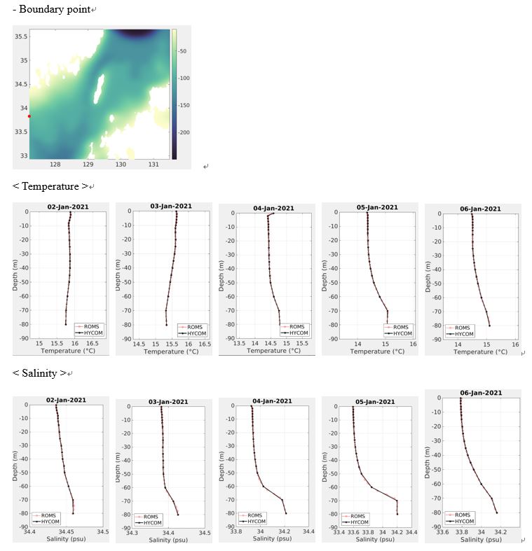

I also simulated setting all initial temperatures to 16 degrees Celsius or 8 degrees Celsius, but this also generated high temperatures that did not come out of the boundary.
All lateral boundary conditions were well interpolated and applied as seen in the vertical profiles (boundary condition type: Clamped).
I have uploaded the input file (roms_ccs.in) andt the header file (ccs.h) I used.
Can someone please tell me why I am getting high temperature even though it is not applied to the boundary and what I should do to fix it?
Best regards,
Bo-Kyung Kim.
