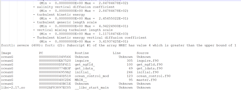

I have encountered this problem when I restart running (debug), I don't quite understand why this is happening, thank you very much

i think it is telling you to set NRREC=1, because there is only 1 time record in that file.
you set it to 4 and there are not 4 time records.

Thank you very much for your reply, I know that my ocean_time only has 1 and 2, I tried to change NRREC to 1, 2 and -1, but this problem occurred all the time. In addition, I changed the restart file, originally I only calculated the dynamic process, but later I added ecological variables to restart. Problems when resubmitting tasks (there were no problems before the change)
There is another question, I would like to ask ru, rv and rzeta in the rst file, what is the meaning of this RHS, do you have more details about them

Are you merging data from different files to create your restart? It looks like you have mismatched dimensions.
Restart RST files have an extra dimension to carry the n-1 and n time levels to restart the time stepping. But if you add in new biology variables that are not dimensioned the same way it won't work. You can restart from a single time record such as a History HIS file.

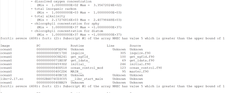

Sorry to bother you again, I still need your help, I restarted this error from his, I realized that it may not be the problem of restart, I started a new task again, compiled roms+cosine from the initial field (ini) startup, there is still this problem, I used to be able to run normally, This recent error for some reason. I urgently need your help, thank you very much!

Not only that, just running the roms will also have this error, I don't think I have changed anything, the first can run the dynamic process also has this error
wanghaoyu wrote: Sat Jun 15, 2024 7:29 pm Sorry to bother you again, I still need your help, I restarted this error from his, I realized that it may not be the problem of restart, I started a new task again, compiled roms+cosine from the initial field (ini) startup, there is still this problem, I used to be able to run normally, This recent error for some reason. I urgently need your help, thank you very much!
