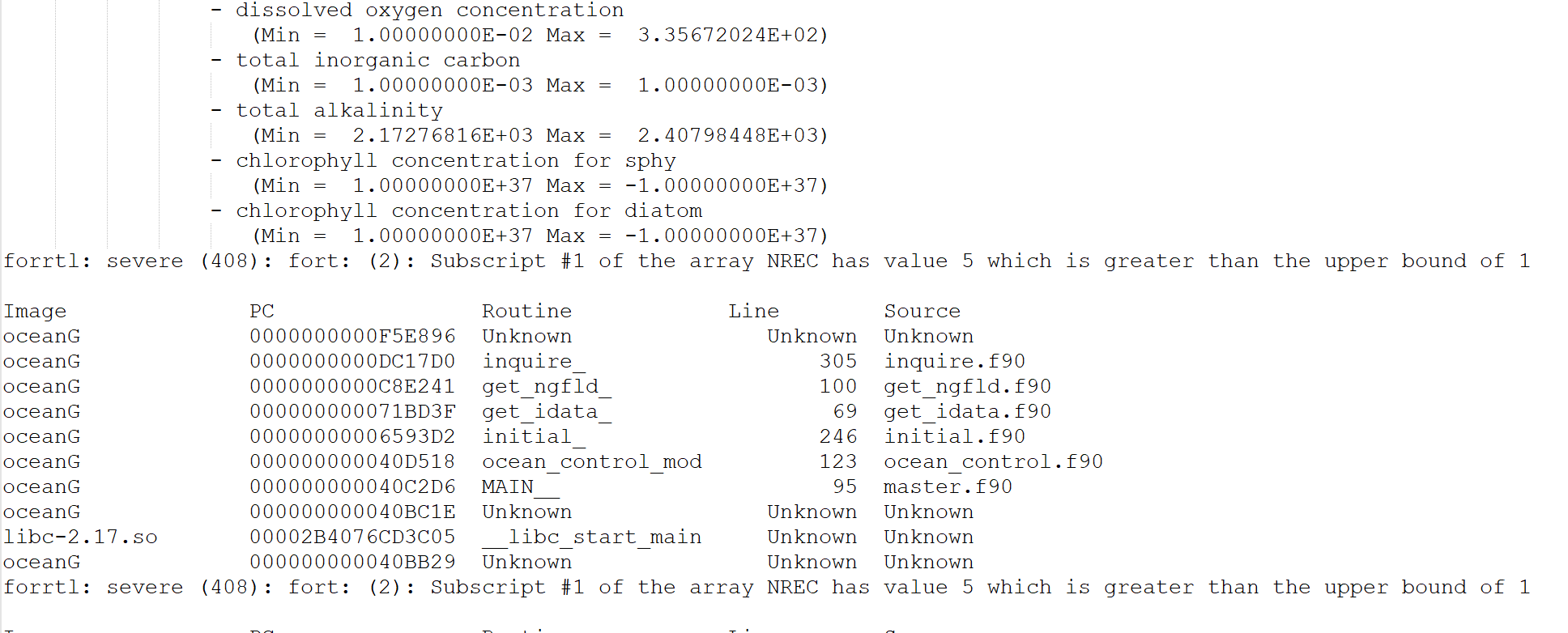

I have encountered this problem when I restart running (debug), I don't quite understand why this is happening, thank you very much

i think it is telling you to set NRREC=1, because there is only 1 time record in that file.
you set it to 4 and there are not 4 time records.

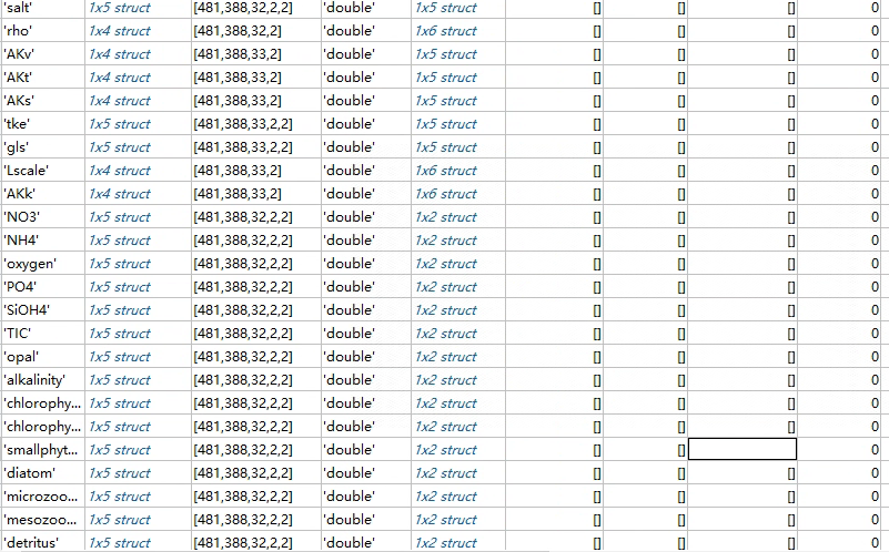

Are you merging data from different files to create your restart? It looks like you have mismatched dimensions.
Restart RST files have an extra dimension to carry the n-1 and n time levels to restart the time stepping. But if you add in new biology variables that are not dimensioned the same way it won't work. You can restart from a single time record such as a History HIS file.

Thank you for your advice. I have noticed the TWO dimensions in the rst file. I noticed that the TWO sets of data in this dimension are very close to each other, so when I created the two dimensions, I gave these ecological variables the same value in this dimension. I don't know if this is the problem.
I was wondering if there is any way that I can implement the restart of adding ecological variables from rstfile and what does the RHS reference in ru, rv, rzeta in the restart file mean.

The additional dimension in a RST file is there to enable a "perfect restart" as if the model never stopped. The long_name of the ru variable documents that it is the RHS of total u-momentum (and likewise for rv, rzeta), which is also required for a perfect restart of the time stepping.
You are adding new biological variables to your initial conditions so you are clearly changing your simulation, so you don't need a perfect restart. Add your new variables to a HIS file snapshot and restart from that. Or #undef PREFECT_RESTART and you sholuld have RST files without the added TWO dimension.

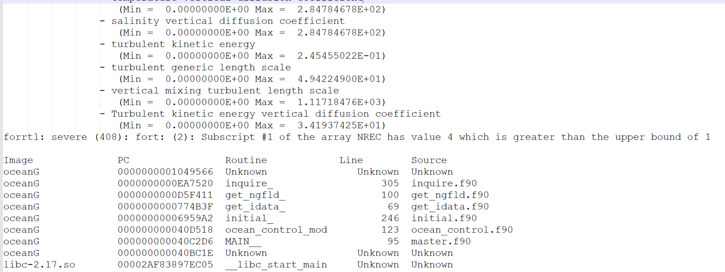

Sorry to bother you again, I still need your help, I restarted this error from his, I realized that it may not be the problem of restart, I started a new task again, compiled roms+cosine from the initial field (ini) startup, there is still this problem, I used to be able to run normally, This recent error for some reason. I urgently need your help, thank you very much!

Not only that, just running the roms will also have this error, I don't think I have changed anything, the first can run the dynamic process also has this error
