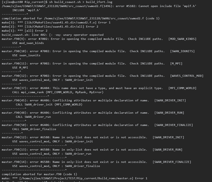

I am using COAWST model (V3.
with ROMS and SWAN couple.
I tried to compile the RIP_CURRENT case and faced with this error. I had no problem compile with ROMS only.
I only get this error when I compile with SWAN only or ROMS & SWAN.
I am using ifort(intel18). Netcdf(4.6.1)
Total log file from compling is attached. I also attach the capture of error.
Please give me any comments regarding this issue.

Re: COAWST JOE_TC case compile error
It looks like your header file mpif.h is either corrupted or located in the wrong path. It could be that it is, compiled with a different compiler/compiler options?
You also have an error in line 402 of your build_coawst.sh script, where you have to delete a space or an extra [.

it would be best to post this on the coawst issue site:
https://github.com/DOI-USGS/COAWST/issues
and include the full output, not just those last few lines.

I have solved this problem, it should still be an issue with the mpi compiler selection.jcwarner wrote: Tue Mar 05, 2024 1:01 pm it would be best to post this on the coawst issue site:
