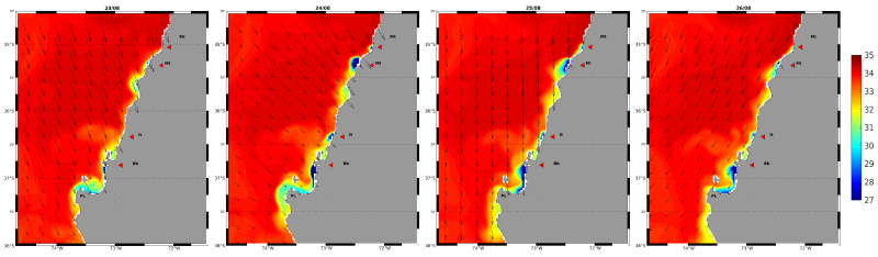

#5 Unread post by crojas »
Sorry for the delay. I've attached a picture showing the daily evolution of SSS. Ml, It and Bb represent rivers and you can see how there is an increase of freshwaters in this regions.
I understand that ROMS interpolate the monthly value so the same amount of freshwater come from the rivers every day, right?
Thanks!
If you have one value for each month, defined let's say at the 15th of every month, then the model will interpolate linearly between consecutive months, and I don't think that will result in the same value every day if the monthly values are different.
