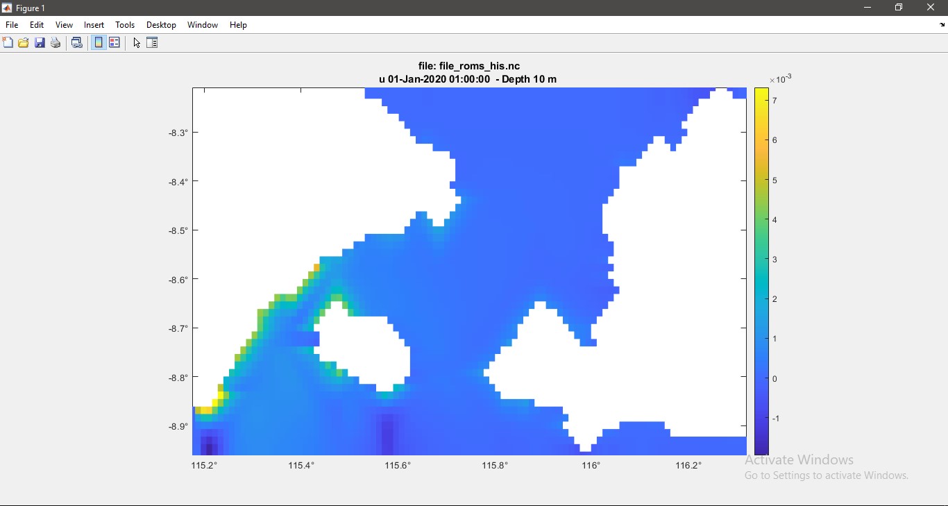

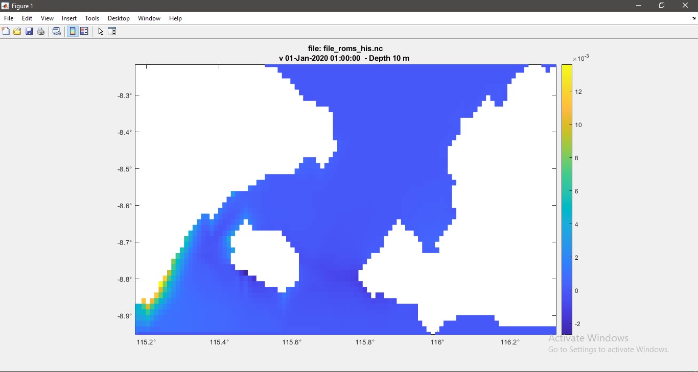

Hello people!
I am facing an issue of exceptionally lower velocity than expected values in one of my simulation results. The expected velocities in my simulation should somewhere be in the range of 0.5 to 1 m/s for the timestamp but my outcomes of each individual momentum field variable at a given timestamp and vertical level are always in the order of ( 10^-3, 10^-4) when I try to visualise it in a pcolour MATLAB plot. I am not sure what is happening there. I tried to modify my quadratic bottom roughness coefficient by reducing it but that didn't help my cause as velocities tend to remain in the same order. This is a problem I am facing quite often. I am pretty sure I am doing something horribly wrong.
What might be the underlying reasons for this anomaly? I am using an external grid, tidal and wind forcing and my initial file is ana_initial. Rest all is pretty much standard ROMS provided dependencies.
My header file looks like this :
#define UV_VIS4
#define SPLINES_VDIFF
#define SPLINES_VVISC
#define BULK_FLUXES
#define BODYFORCE
#define ANA_SMFLUX
#define ANA_STFLUX
#define ANA_INITIAL
#define ANA_SSFLUX
#define ANA_DRAG
#define SSH_TIDES
#define UV_TIDES
#undef RAMP_TIDES
#define ADD_FSOBC
#define ADD_M2OBC
And my parameters in the .in executable look something like this:
Resolution, Grid 01: 98x48x15, Parallel Threads: 1, Tiling: 1x1
6000 ntimes Number of timesteps for 3-D equations.
30.000 dt Timestep size (s) for 3-D equations.
360 nRST Number of timesteps between the writing of data
360 ninfo Number of timesteps between print of information
60 nHIS Number of timesteps between the writing fields
0 nQCK Number of timesteps between the writing fields
into quicksave file.
0.0000E+00 nl_visc4 NLM Horizontal, biharmonic mixing coefficient
(m4/s) for momentum.
1.0000E+00 Akv_bak Background vertical mixing coefficient (m2/s)
2.6500E-04 rdrg Linear bottom drag coefficient (m/s).
2.0000E-03 Zob Bottom roughness (m).
1.0000E+01 blk_ZQ Height (m) of surface air humidity measurement.
1.0000E+01 blk_ZT Height (m) of surface air temperature measurement.
1.0000E+01 blk_ZW Height (m) of surface winds measurement.
12 levsfrc Deepest level to apply surface stress as a
bodyforce.
1 levbfrc Shallowest level to apply bottom stress as a
bodyforce.
8.0000E+00 theta_s S-coordinate surface control parameter.
4.0000E+00 theta_b S-coordinate bottom control parameter.
20.000 Tcline S-coordinate surface/bottom layer width (m) used
2922.000 dstart Time-stamp assigned to model initialization (days).
2922.000 tide_start Reference time origin for tidal forcing (days).
20000101.00 time_ref Reference time for units attribute (yyyymmdd.dd)
5.0000E+01 Tnudg(01) Nudging/relaxation time scale (days)
0.0000E+00 obcfac Factor between passive and active
5.000 T0 Background potential temperature (C) constant.
1028.000 R0 Background density (kg/m3) used in linear Equation
of State.
1.0000E-04 Tcoef Thermal expansion coefficient (1/Celsius).
0.0000E+00 Scoef Saline contraction coefficient (1/PSU).
T Hout(idOvel) Write out omega vertical velocity.
T Hout(idUsms) Write out surface U-momentum stress.
T Hout(idVsms) Write out surface V-momentum stress.
T Hout(idUbms) Write out bottom U-momentum stress.
T Hout(idVbms) Write out bottom V-momentum stress.
T Hout(idPair) Write out surface air pressure.
T Hout(idTair) Write out surface air temperature.
T Hout(idUair) Write out surface U-wind component.
T Hout(idVair) Write out surface V-wind component.
T Hout(idDano) Write out density anomaly.
Are there any possible modifications that I could try in my .in file executable so as to improve my u,v,w momentum values? Or it's a fundamental error in my grid file and forcing files?
Kind regards
-Neel

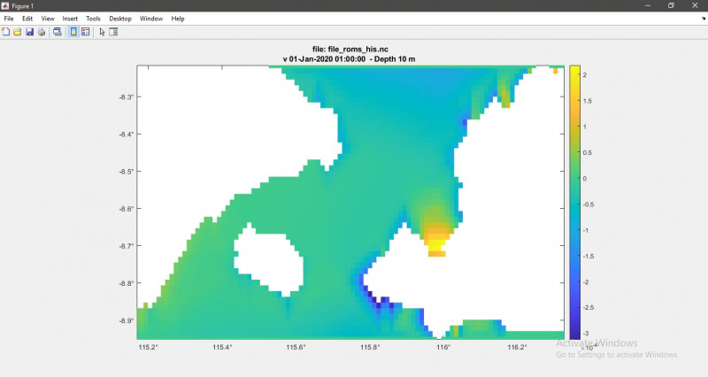

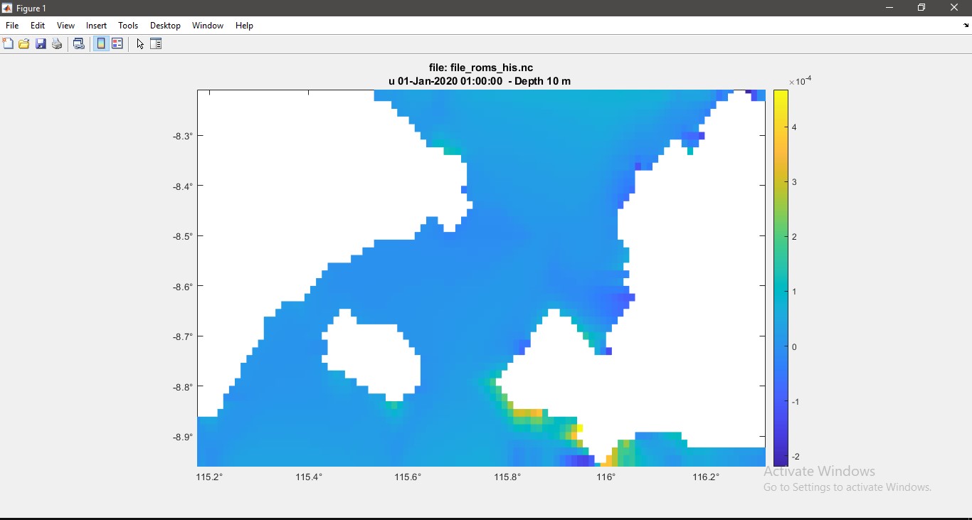

neelbasak08
Posts: 99
Joined: Wed Dec 09, 2020 3:58 pm
Location: Thapar Institute of Engineering and Technology, Patiala, PN, India
Re: Issue of exceptionally low velocity
#7 Unread post by neelbasak08 »
Thanks Mr. Wilkin!
As per your suggestion, I remove ANA_SMFLUX from my header file and removed ANA_FSOBC and ANA_M2OBC as well. Just defined bulkflux and other previous headers.
I see an improvement in my velocity profile where its order changed from a factor of 10^(-4) to 10^(-3), but it's still not in the desired order of 10^(-1) to 10^(0). Is there anything more that I might be doing wrong?
I see the following section in my terminal log:
ANA_INITIAL - u-momentum component: u
(Grid = 01, Min = 0.00000000E+00 Max = 0.00000000E+00)
ANA_INITIAL - v-momentum component: v
ANA_INITIAL - potential temperature: temp
(Grid = 01, Min = 5.00000000E+00 Max = 5.00000000E+00)
GET_NGFLD - tidal period
(Grid = 01, Min = 2.19720214E+04 Max = 2.38071314E+06)
GET_2DFLD - tidal elevation amplitude
(Grid = 01, Min = 0.00000000E+00 Max = 6.75112534E-01)
GET_2DFLD - tidal elevation phase angle
(Grid = 01, Min = 0.00000000E+00 Max = 6.25560811E+00)
GET_2DFLD - tidal current inclination angle
(Grid = 01, Min = 0.00000000E+00 Max = 6.14146610E+00)
GET_2DFLD - tidal current phase angle
(Grid = 01, Min = 0.00000000E+00 Max = 6.28317974E+00)
GET_2DFLD - maximum tidal current, ellipse major axis
(Grid = 01, Min = 0.00000000E+00 Max = 2.37040469E-01)
GET_2DFLD - minimum tidal current, ellipse minor axis
(Grid = 01, Min = -1.00770225E-03 Max = 5.12410660E-02)
I am not sure where ROMS is getting my tidal data from my input tidal file. If that's the case, then why is it not fetching data from my tidal forcing, I can see it has read it
Output Restart File: Lombok_roms_rst.nc
Output History File: Lombok_roms_his.nc
Input Grid File: /home/sbasak08/roms/Projects/Lombok_Straits/lombok_v3_grd_test.nc
Tidal Forcing File: lombok_v3_grd_test01Jan2020_v5.nc
Input Forcing File 01: lombok_v3_grd_test01Jan2020_v5.nc
Input Forcing File 02: frc_MYAPPLICATION_ERA5_bulkflux_lombok_v3_grd_test_2008202001.nc
ROMS I/O variables Metadata File: External/varinfo.dat
As to Kate's question on how my wind stresses look like, it shows something like the following at my final timestamp:
GET_2DFLD - surface u-wind component, 2020-01-01 23:00:00.00
(Grid=01, Rec=24, Index=2, File: frc_MYAPPLICATION_ERA5_bulkflux_lombok_v3_grd_test_2008202001.nc)
(Tmin= 3013.0000 Tmax= 3042.9583) t = 3013.9583
(Min = -3.03207905E-02 Max = 3.75902466E+00) regrid = T
GET_2DFLD - surface v-wind component, 2020-01-01 23:00:00.00
(Min = -8.90646992E-01 Max = 1.98579395E+00) regrid = T
What could I be doing wrong, that my velocities in the output file are such extremely low? Is there any way to fix these issues?
Kind regards
-Neel
without ana_smflux_error.txt
log file
(102.26 KiB) Downloaded 927 times
Posts: 936
#8 Unread post by wilkin »
Your log file shows all open boundaries are "Closed". You need Chapman and Flather conditions for the tides to be active. Set the appropriate LBC options in roms.in
