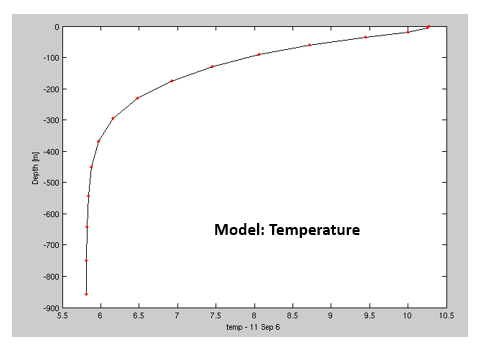

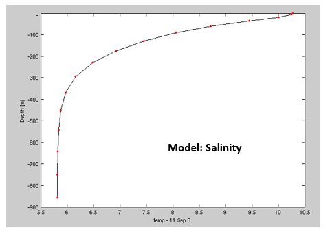

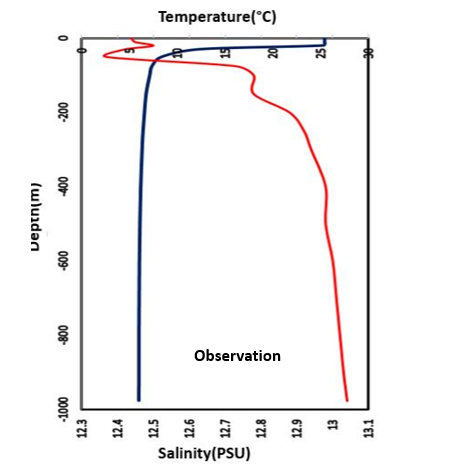

Dear Users,
I ran the model for 6 years with this .h. The result does not show proper vertical temperature and salinity.Here I compare with observation. I try to model the temperature, salinity, and circulation of my domain. How to solve this problem?
Please help me with your interesting comments.

- temp.PNG (15.39 KiB) Viewed 99161 times
- sal.PNG (15.29 KiB) Viewed 99161 times
- observ.PNG (70.19 KiB) Viewed 99161 times
Re: Wrong Temperature and salinity outputs
Your model is salty at the surface when it should be fresh. What are you using for fresh water forcing?
I used river runoff when activating #undef ANA_PSOURCE. Also, I think that the model has a problem in flux too as the water is a little cooler than observation. I think that the model has a problem with vertical forcing and fluxes.
So how are you forcing it? You have:
Note that I have been using BULK_FLUXES (with CCSM_FLUXES) and atmospheric reanalysis fields for over a decade now.
Are these set to zero or something reasonable?#define ANA_STFLUX
Dear Kate
Thanks for your response.
I try to model the temperature, salinity, density, and water circulation(eddies) of my domain, not biology work . Based on your response, I have reviewed your application at Github(Apps-master). I have changed my upwelling.h file. here is the new one. Is it ok?

No. I think that this is ok. I have downloaded from ECMWF and merge months. Like this, is it ok? maybe, the time is a problem?
NFFILES == 13 ! number of unique forcing files
FRCNAME == /media/java/G/2013/gom_cloud_era1.nc |
/media/java/G/2014/gom_cloud_era2.nc |
/media/java/G/2015/gom_cloud_era_3.nc |
/media/java/G/2016/gom_cloud_era_4.nc |
/media/java/G/2017/gom_cloud_era_5.nc |
/media/java/G/2018/gom_cloud_era_6.nc \
/media/java/G/2013/gom_latent_era1.nc |
/media/java/G/2014/gom_latent_era2.nc |
/media/java/G/2015/gom_latent_era_3.nc |

What is the time variable like in one of these things? You need one common time origin for *everything*.
I use ecmwf2roms Matlab manuscript to make forcing. I use
DSTART = 0.0d0 ! days
TIDE_START = 0.0d0 ! days
TIME_REF = 20130101.5d0 ! yyyymmdd.dd
I do not know but we have different times for each variable.
