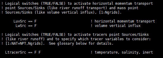

#5 Unread post by 19zsheng »
Thanks again for your help.
When I set the parameters in the .in file as shown in the image below, my problem is solved, but I don't know why?
