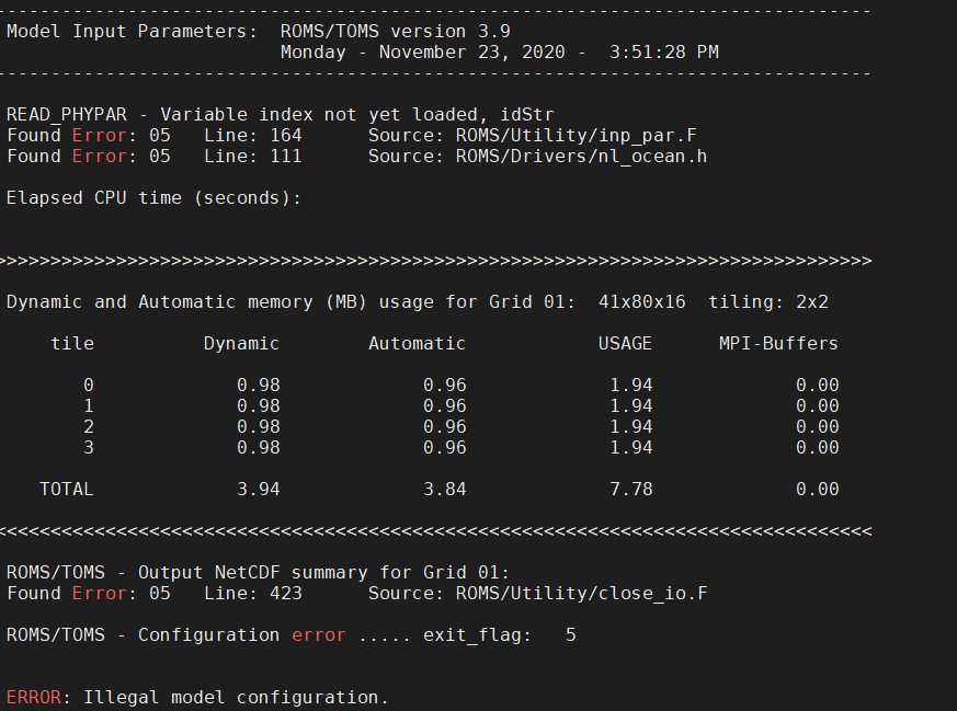

Hi , I am currently new to ROMS, compile is successful, but I got the error messgae when trying to run the default upwelling case,
I used the following command :
mpirun -np 4 romsM ./External/roms_upwelling.in > & log &
the error message is follows:
Does anybody has same problems before? any suggestion might help, Thanks in advance.

You need to use a varinfo.dat file which is consistent with your ROMS version. idStr is in some varinfo.dat files:
'strain'                                           ! Output
  'strain'
  'second-1'                                       ! [1/s]
  'strain, scalar, series'
  'ocean_time'
  'idStr'
  'p3dvar'
  1.0d0
