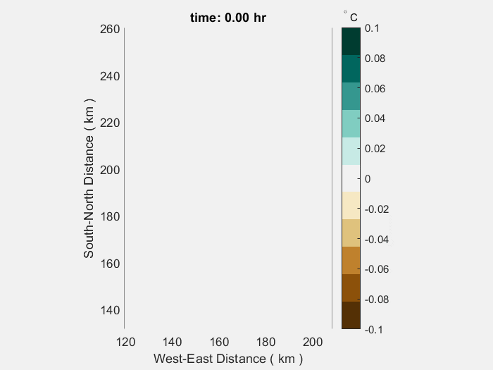

Here is follow-up on a problem I posted previously. I did a two-way nested simulation of the outward propagation of surface gravity waves from the a collapsed sea-surface mound (see attached animation). The horizontal resolutions of the small domain is 5 times that of the large domain. There is no forcing other than the surface mound in the initial conditions. The seafloor is flat and has a depth of 100 m.
In my previous post, I mentioned an issue of emergency bailout when using MPI. I took the advice from the developer and changed the grid size of the two nested domains so that the numbers of grid points on each side are uneven. This had first appeared to solve the problem as the MPI run finished without bailout. However, it seemed that I celebrated too soon because the same bailout issue occurred when I tried a different number of processors. I then did a debug run and the following is the diagnostics, which report 'illegal model configuration' and ' CHECKDEFS - explicit time-step splitting is inconsistent'.
Another issue I noticed is that, although there is no stratification in temperature, which is set to 2 degree C in initial conditions for both grids, anomalies appear to show up in the small domain as can be seen in the second animation, which shows the temperature anomaly (absolute minus 2 degree) at 20 m over the small, fine-resolution domain. Those numerical anomalies in temperature show up in both serial and MPI runs and reducing the time step used for the small domain does not seem to help.
I think those temperature anomalies are probably caused by the error in model configuration, but I have no idea how to further diagnose the problem. Could anyone give some advice?
Thanks in advance!

Thanks again for your feedback, Arango. Those animations were generated from a serial run that finished without apparent blow up. The error message was actually from a debug run, which I now realize was in barotropic mode by default. So I now see that the error message is not related to the numerical anomalies in temperature.
On the other hand, when I run the same simulation using MPI with only one processor, the run quickly blew up within the first few time steps as indicated in the on-screen output below. When I use more than more processor, the blow up still happened but later. I think those numerical anomalies in temperature from the serial run are likely related to the cause of the blow up when using MPI.
Maybe this is a telltale sign that the two-way nested grids were not set up properly?

xupeng66
Posts: 81
Joined: Sat Mar 06, 2010 3:38 pm
Location: University of Washington
Re: inconsistent explicit time-step splitting in two-way nesting
#4 Unread post by xupeng66 »
I think I have found the cause of problems. It turns out that I forgot to specify the horizontal and vertical advection schemes for temperature for the fine grid. I feel frustrated that it took me so long to spot such a simple mistake in the model setup. The roms.in file I used for the nested simulation was converted from the one I used for single-grid simulations. I thought I made all the changes needed but apparently I had missed something very important. This is good learning experience for me, though.
Cheers!
