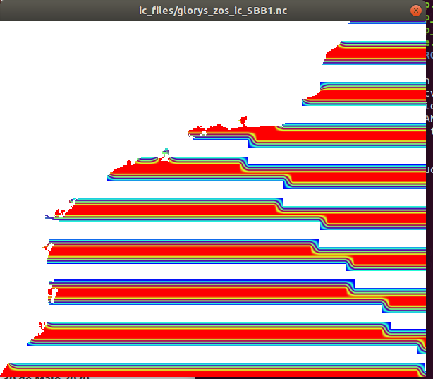

I tried to create once, but the problem is that glorys12v1 files come only with 'rho-points' coordinates, and my attempt to create u and v grid and use in the interpolation generates a weird field (as in the figure attached for zeta).
Thank you for your help.
zeta fields after interpolation

nilodna
Posts: 6
Joined: Thu May 02, 2013 6:38 pm
Location: Oceanographic Institute from University of Sao Pau
Re: pyroms with mercator dataset
#5 Unread post by nilodna »
Thanks, Kate, that will be very helpful.
