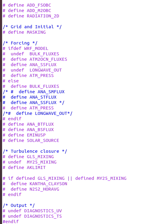

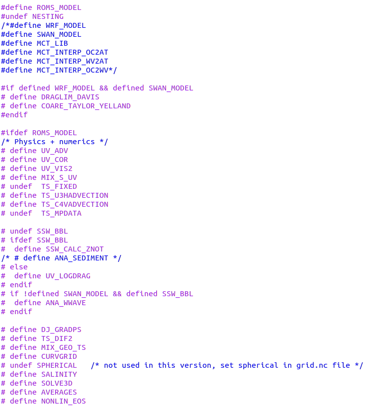

And these are my CPP options:
 SSE                 ROMS SSE 112
 BULK_FLUXES         Surface bulk fluxes parameterization.
 DIFF_GRID           Horizontal diffusion coefficient scaled by grid size.
 EMINUSP             Compute Salt Flux using E-P.
 LONGWAVE_OUT        Compute outgoing longwave radiation internally.
 MIX_GEO_TS          Mixing of tracers along geopotential surfaces.
 MY25_MIXING         Mellor/Yamada Level-2.5 mixing closure.
 K_GSCHEME           Third-order upstream advection of TKE fields.
 RADIATION_2D        Use tangential phase speed in radiation conditions.
 RI_SPLINES          Parabolic Spline Reconstruction for Richardson Number.
 SOLAR_SOURCE        Solar Radiation Source Term.
 SPLINES_VDIFF       Parabolic Spline Reconstruction for Vertical Diffusion.
 SPLINES_VVISC       Parabolic Spline Reconstruction for Vertical Viscosity.
 SPHERICAL           Spherical grid configuration.
 TS_C4HADVECTION     Fourth-order centered horizontal advection of tracers.
 TS_DIF2             Harmonic mixing of tracers.
 VISC_GRID           Horizontal viscosity coefficient scaled by grid size.

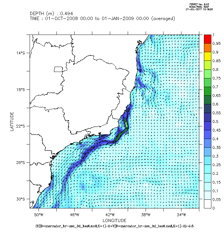

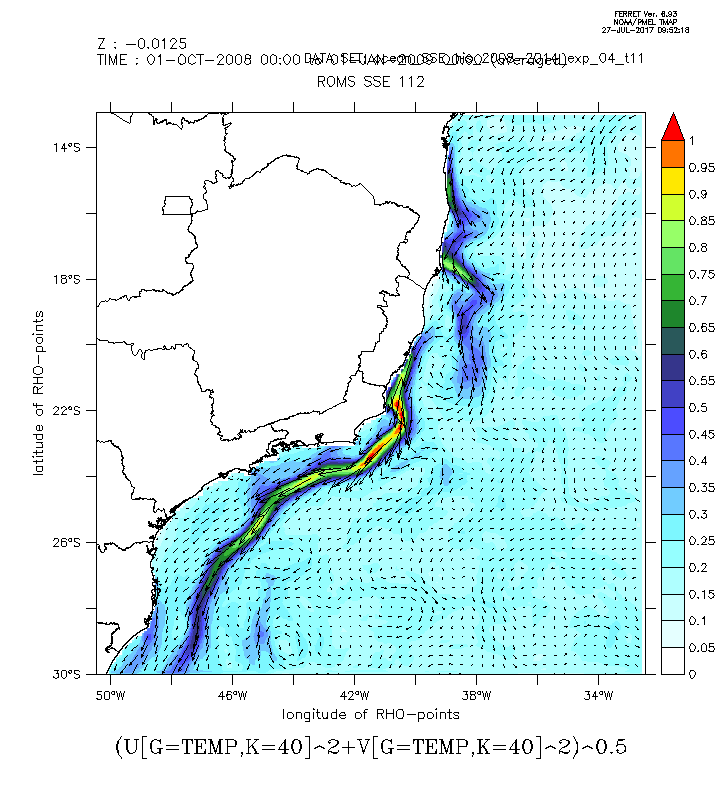

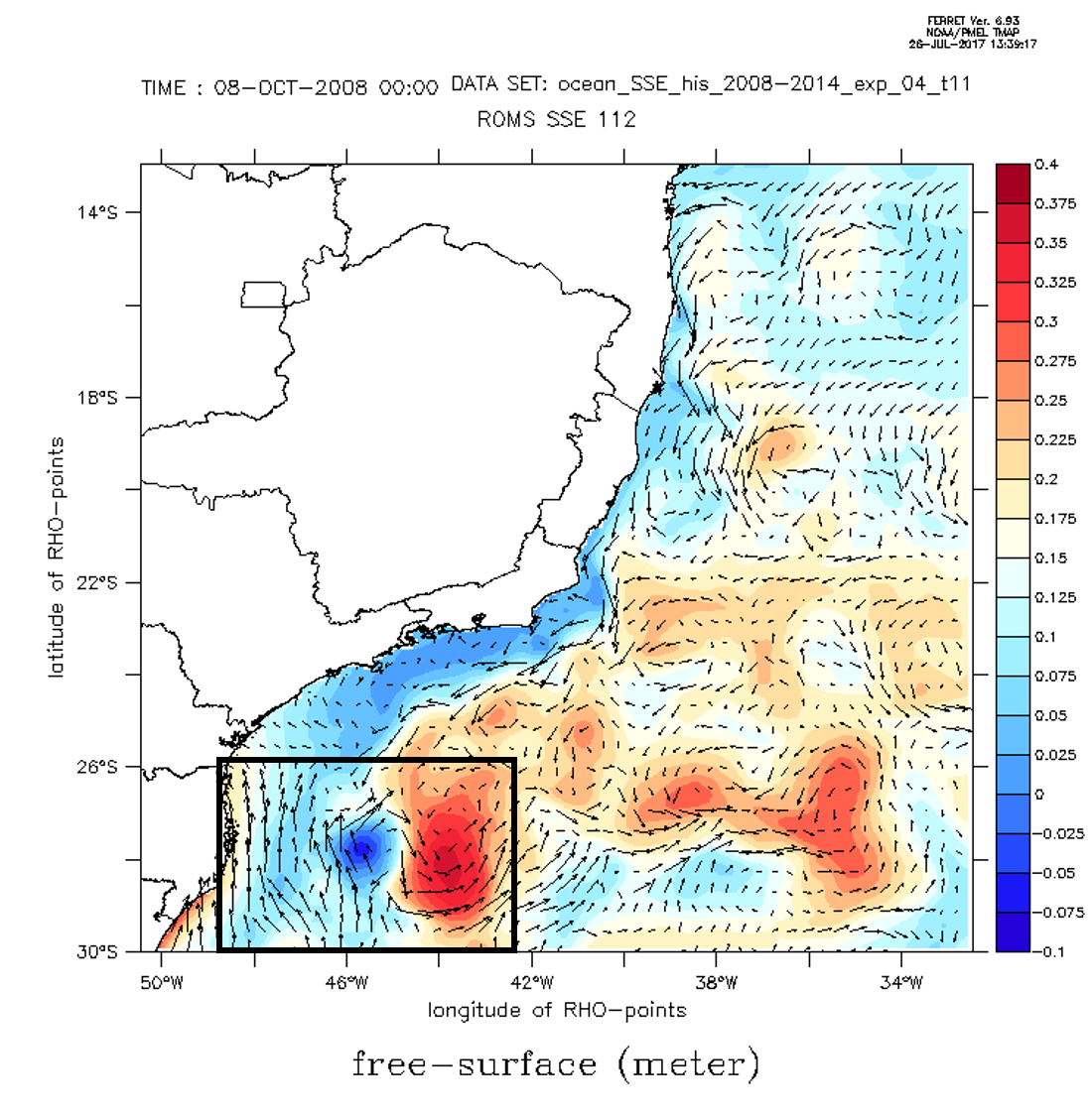

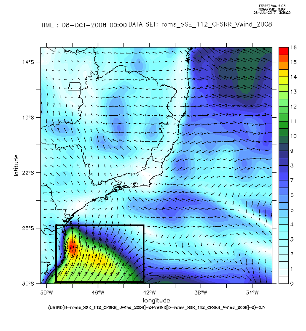

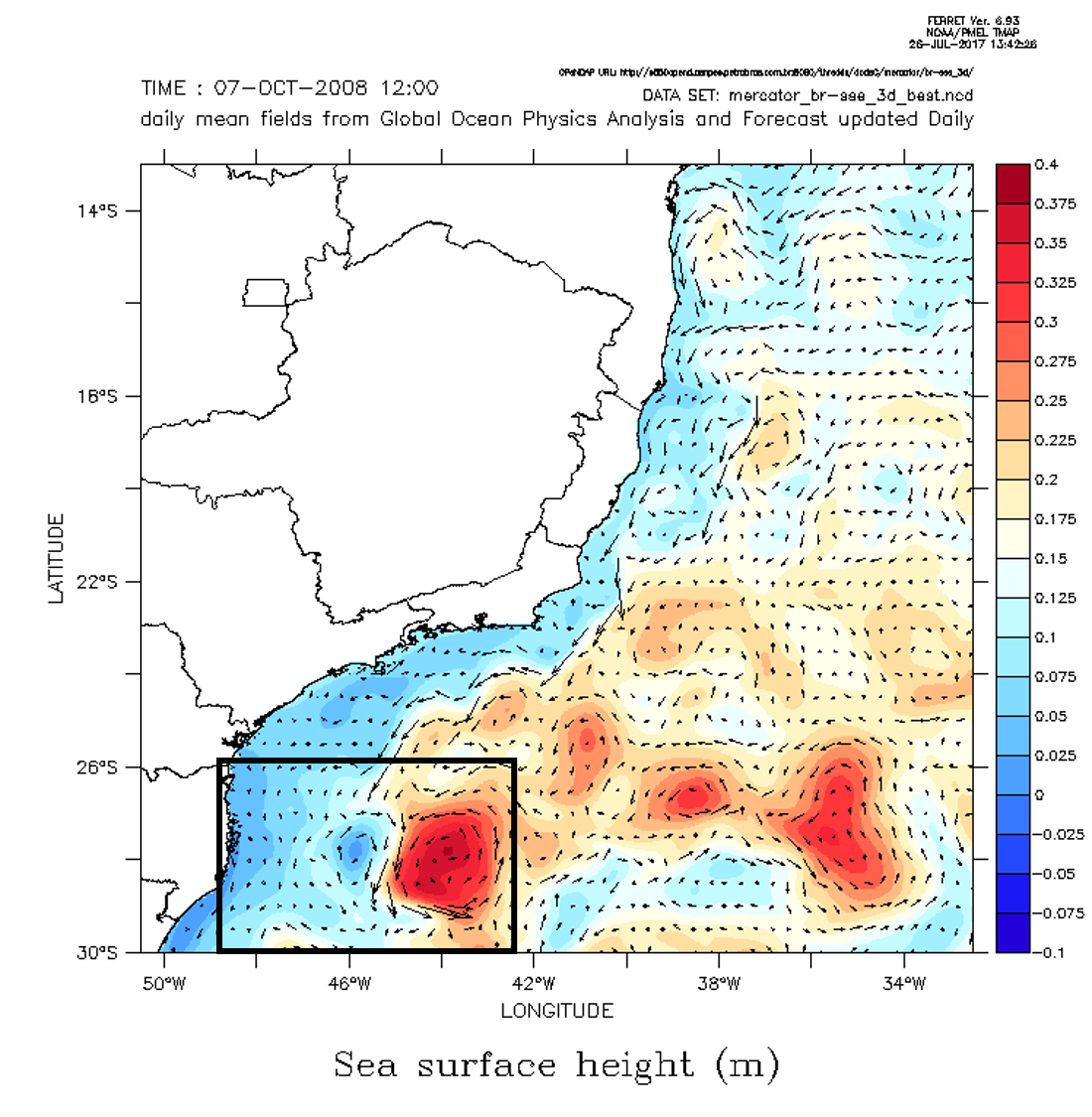

The problem can be seen in the attached pictures, which shows a snapshot of surface currents and SSH from ROMS and from global MERCATOR model, to which I nested my grid, a few days after initialization. A snapshot of wind velocity is also shown.
I was expecting a geostrophic flow where currents vectors would follow more or less elevation gradients, as it happens on MERCATOR and in situ measurements show. However, currents on ROMS are stronger and presents a drift at the same regions where wind speed is also stronger, suggesting a possible overestimation of wind stress in my model.
At the beginning I thought this behavior would be restricted to the very near surface layer. However, the drift can be seen in deeper layers down to a ~ 50 m depth or more, specially on shallower regions.
The average flow seems to be overestimated as well, as shown in the pictures of averaged surface currents. ROMS currents are stronger than MERCATOR and other global models such as HYCOM NCODA, specifically along the slope in the domain of Brazil Current.
I made a few tests altering vertical mixing scheme (MY25, GLS k-epsilon, LMD), increasing viscosity (from 4.0 to 25.0 m2/s) and changing CFSR hourly data to ERA INTERIM 6 hourly fields, but I'm not satisfied yet. Near surface currents remains stronger than expected for the region and I wouldn't like to have mesoscale features vanished by high viscosity values.
A few doubts I have:
1. Are my high velocities and currents drift due to strong wind stress or have I misinterpreted my results? What else could be causing this behavior?

Thanks in advance for any help.

I don't remember the exact steps I took, but the flag WIND_MINUS_CURRENT (see: https://www.myroms.org/projects/src/ticket/758) along with a fine tweak in viscosity (nl_visc2) led me to better results.
Besides comparing to global models, I also made some comparisons with in situ data (with appropriate time filtering) and the modeled velocities were in a reasonable range.

Hello, I wonder that the magnitute of the wind speed you used.
I also met the problem that the currents were too strong. My wind speed is up tp 58m/s. I don't know that if the scheme in ROMS can adapt to the 58m/s-wind speed, or if there is something wrong in my cpps.
mainara

Mainara, Thank you for your reply. I am using COAWST, but I just use the ROMS part in COAWST.I don't difine the WRF or SWAN

I suggest you first to read a few papers related to the wind stress formulations in extreme events like TC, many of them are John's papers using COAWST and many Hurricane cases etc. Not to just blindly run ROMS model and then expect to get result that is perfect.
For example:
Bryant & Akbar in JMSE 2016 doi:10.3390/jmse4030058 where you can see limits for drag formulations or
Hwang in JPO 2018 doi:10.1175/JPO-D-18-0107.1 for new formulation having more physical background and saturation of wind drag for TC at wind speeds > 30m/s
As you wrote, you are using COAWST, then it would make sense to use coupling and have better formulation coming from the wave model which is then fed back to WRF model providing forcing for ROMS model. This is the way to go, step by step.

But, are you only using ROMS why use the COAWST ?
I agree with Ivica, if you do not use the functions of a coupled model, it does not make sense to use it.
Do you use the tidal forcing and river data?
What atmospheric and ocean forcing are you using?
On what machine do you perform your simulations?
I noticed that you did not use some CPPs, such as:
#define SPLINES_VDIFF
#define SPLINES_VVISC
#define VISC_GRID
# define DIFF_GRID
# define LMD_CONVEC
# define LMD_SKPP
# define LMD_NONLOCAL
# define LMD_SHAPIRO
# define ALBEDO_CURVE
I do not have much modeling expertise, but I can attachment to you my .in and .h in the study area.
If you want, mainarabg@gmail.com

Thank you for your reply, Ivica. You really help me a lot. Wind stress is the issue point, and I will read more papers to figure out this.

Thank you for your reply and I have found that the problem is the wind stress. After I modified the wind stress formula, I got better result.
Thank you!
