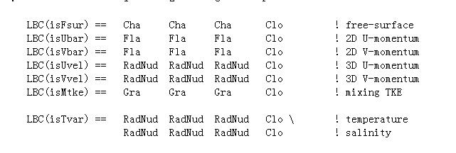

My model is blowing and I don't know why. I tried to change the time step but the only thing it does is to delay the
blowing up.
if i do not add river files its work fine. But if i add river transport, i am getting error..
I need help on this one

zeta 1 Chapman Imp Chapman Imp Chapman Imp Closed
ubar 1 Flather Flather Flather Closed
vbar 1 Flather Flather Flather Closed
u 1 Radiation Radiation Radiation Closed
v 1 Radiation Radiation Radiation Closed
temp 1 Radiation Radiation Radiation Closed
salt 1 Radiation Radiation Radiation Closed
tke 1 Gradient Gradient Gradient Closed

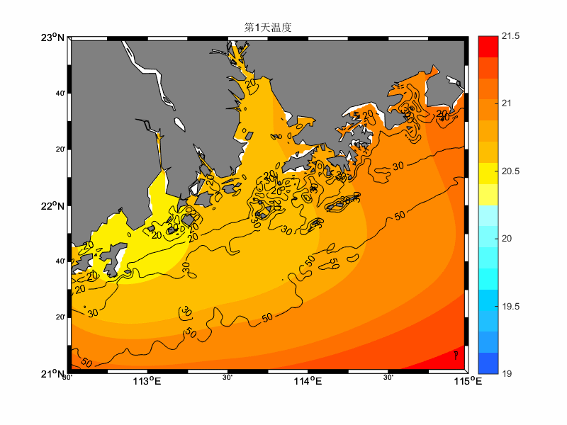

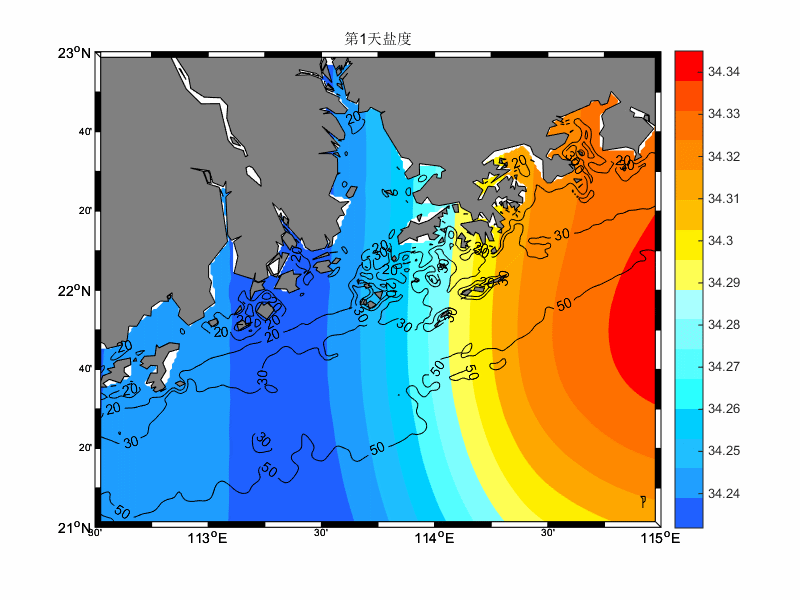

I tried to change the discharge, and I find the small discharge would not occer with this problem, but the trend of the salinity is not correct like it should be.
the first picture is the location of 8 rivers, and the second picture is the gif I make from MATLAB.
Re: Blowing-up: Saving latest model state into RESTART file
Frame 1 of the movie is different, but it goes by so fast I can't tell what's in it.
When the rivers are full strength, how does it actually go bad? Too strong a velocity? How deep are the river inflow locations? What is the vertical profile of the inflow? Are you providing an inflow temperature as well?

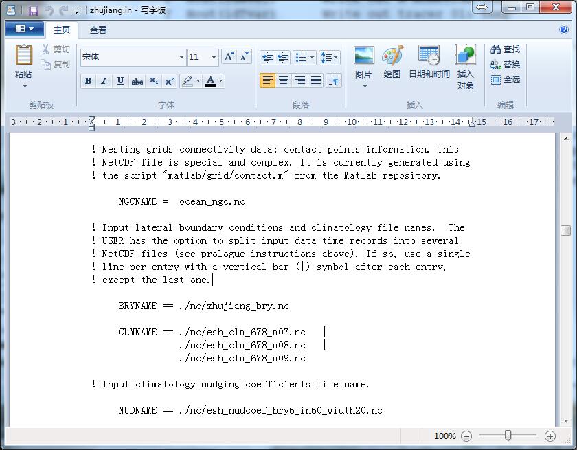

Now I want to know that, if I use the make_bry.m to make a boundary file, what parameter should I define in the .h file, because when I run this model, I couldn't find the 'bry.nc' in the list of input files. Thank you very much!

The model will read the boundary file (or not) based on the value of the LBC boundary options. I use RadNud for 3d fields and a combination of Cha/Fla or Che/Shc for the 2d fields. Those will need boundary values.

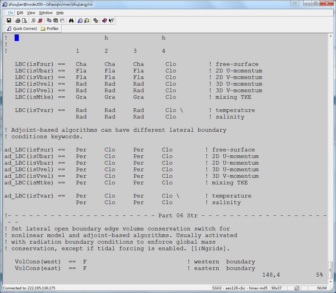

Thank you very much, and I want you to check that how I set of the boundary condition, and what I write in that 'zhujiang.in' file. But my program blowing up , and I couldn't find the 'bry.nc' file in the log file. I don't know why. So I think if I had missed define something in the '.h' file.kate wrote:The model will read the boundary file (or not) based on the value of the LBC boundary options. I use RadNud for 3d fields and a combination of Cha/Fla or Che/Shc for the 2d fields. Those will need boundary values.
The Cha/Fla combo won't read your boundary file with these:
because you are using analytic fsobc and m2obc.Analytical header files used:
ROMS/Functionals/ana_btflux.h
ROMS/Functionals/ana_fsobc.h
ROMS/Functionals/ana_m2obc.h
Yes, I had thought that reation, but if I delete the #define ana_btflux , it would error, and mention missing btflux.kate wrote:The Cha/Fla combo won't read your boundary file with these:because you are using analytic fsobc and m2obc.Analytical header files used:
So, if I don't define ana_btflux, what should I define in '.h' file?
Sorry, yes, you need ana_btflux for bottom temperature fluxes. What open boundary fields are you providing?
Again, what do you want it to be doing? For which fields are you providing boundary values?
I see you have tidal elevations but not tidal currents. Better to provide both if you can - the tidal models I use have the currents.
This is likely to ask for a forcing file:because you dropped ANA_STFLUX. You also don't have ANA_DQDSST - the QCORRECTION will be wanting a dqdsst, whether analytically or via a file.
[quote="kate"]Again, what do you want it to be doing? For which fields are you providing boundary values?
I changed my definition of the boundary condition from 'Rad' to 'RadNud', then it will read the boundary file.
And it blew up because the position of the river is incorrect, and it's okay now.
Thank you again.

[imgh=][/imgh]kate wrote:This is happening before your first timestep. You need to look at your initial conditions file.
Dear kate;
Sorry to bother you so much.
I check my '.in' file, and when I changed the boundary condition from 'RADNUD' to 'Rad', it would be ok, but that would not read 'bry.nc' file. So, I think that the 'bry' I made was wrong, if you could send me some '.m' file to make 'bry.nc' file. Thank you very much!
My email is lizhaoqin@stu.ouc.edu.cn
- QQ截图20170511220544.jpg (25.36 KiB) Viewed 12629 times
Do you have the official ROMS Matlab tools? There are actually two sets, one from myroms.org, one from the French croco team. I can't help you with either, however.
