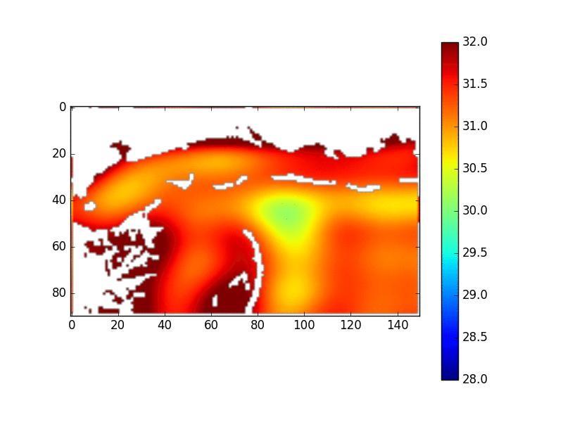

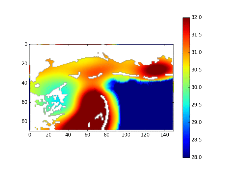

So I figured out you can upload animated gifs, so I am attaching a couple here. I am only doing short model runs at this point. It is the bottom layer that the cold is creeping in, and the surface has the opposite problem. I did try setting my nudging timescales, but the problem still remains:

I think I've figured out my problem. I think the data arrays in my boundary files are backward. At first I thought the lines at the edges of my animations were artifacts of my laziness. But that is the actually output in my _his file. It seems the script I used to create my boundary file was expecting the climatology data in the inverse order. I guess there's only one way to find out at this point. At least I learned a lot about nudging :)
