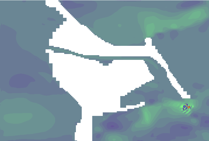

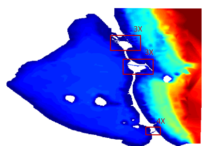

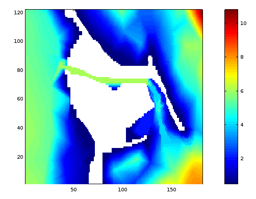

I am running a nested simulation. It have 3 child grids for 3 channels with a resolution about 10 meters. The channels are quite narrow (50/70 m width) and shallow (5 meters). I have used different vertical mixing schemes: MY25, GLS and LMD. If I use GLS or LMD my model is very stable but I get low current velocities compared to the one measured by the ADCP deployed in the area but if I use MY25 my velocities are more realistic but my model get unstable. I have been doing different test but I always get the same results (MY25 more realistic but unstable). I will really appreciated any help or suggestion.
Thanks a lot.

Dear Kate,
Thanks a lot for your answer and your help. The model get unstable after 4 hours, the wind blowing at this time is not very strong (5 m/s) and the sea level variations quite small. I have tried to use smaller time steps, different values for RDRG2 and several sigma layer distributions but I always get the same results. If I use other vertical schemes (GLS or LMD) my model is stable but the effect of the wind is very small and I don’t get realistic values for the current. I am only able to get them if I use the MY25 scheme. Below you will find two plots: the bathymetry and the u-component where the instability can be seen clearly.
- unestable_channel.png (23.61 KiB) Viewed 19700 times
- Bathymetry
- channel.png (26.25 KiB) Viewed 19700 times
Re: very diferent velocitities using GLS,MY25 or LMD
Your model bathymetry in general is quite shallow and it blows up in a region where the water depth < 2m. Does the model have tides? If so what is the tidal range? Have you tried switching on the wetting-drying in ROMS?

Dear Lyon Lanerolle,
Thanks a lot for your answer I am working in a quite shallow area. I have tides but the tidal range is very small (max. 20 cm) so the area never get dry.
Regards,
-Francisco

The white area in the pictures showed in my post correspond to the mask_rho.
Yes, the minimum depth in my domain is 0.5 meters to ensure that I am not going to have any dry area.
My problem come using the MY25 vertical scheme, if I use other scheme my model is stable but I get low velocities.

Dear Kate,
Thanks a lot for your help. Attached you will find a plot of the coarser grid and the three nested grids. Two of the nested grids are refined to a scale of 3 and another one to 4. In the plot is showed this values. I have changed the values of VISC2 increasing the value for the coarser grid and re-launch the model.
Dear Lyon,
I have launched the model with your configuration but I am getting the same problem.
Dear Lyon,
- nested_grids.png (100.91 KiB) Viewed 19638 times
