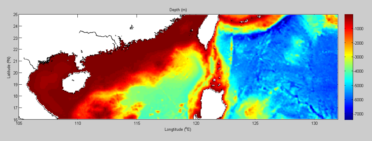

Does your domain include equator?
If it's ok for you, I want to see your model domain.
-JH

My domain doesn't include equator.It's 16N - 24N, 105E - 132E, in north South China Sea.
