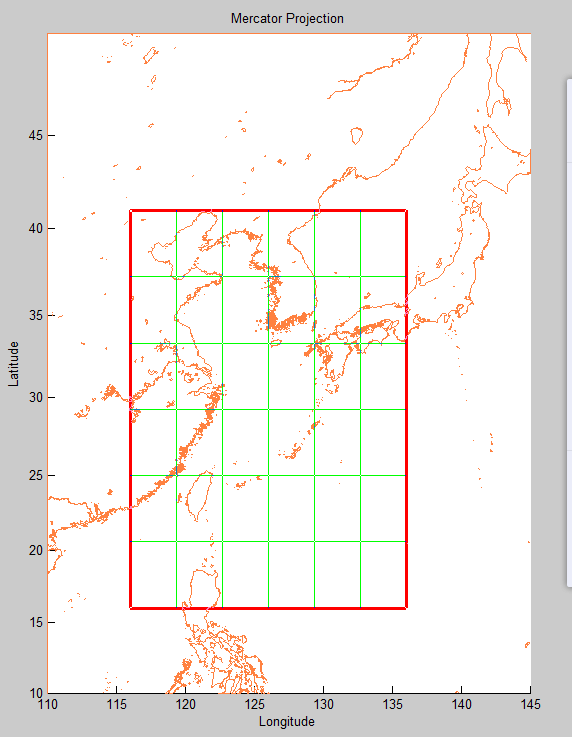

my simulate area :
simulate area
simulate area
simulate area.png (14.8 KiB) Viewed 4940 times
grid size is 5'*5'

Here comes focus ; simulate for two years ;The outcome is some kind driving me crazy

from all the graphs in the .rar, there are two annoying eddies sucking all the waters which i want them to flow through Okinawa trough out the trough .
And , i am trapped in this situation .
sos
sos
Any advice would be appreciated sincerely
