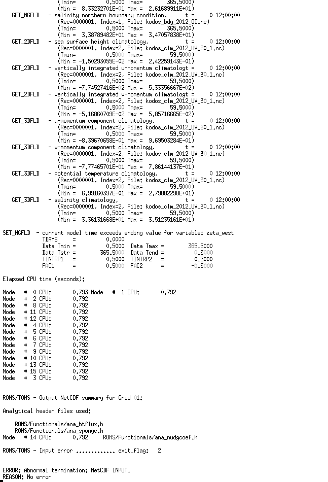

When i run roms model, i have some errors.
the log file show that like this.
'current model time exceeds ending value for variable : zeta west'
Even if, i check time of zeta west, i could't understand why this error represented.

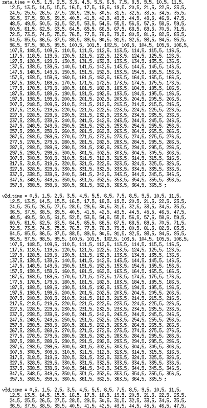

the dimension of this variable, zeta west,is (zeta_time, erho).
And i run the model for 1 year(366 days)
This picture shows that zeta time.
and i use nudging scheme for 3D velocity. This time interval is 1 day.

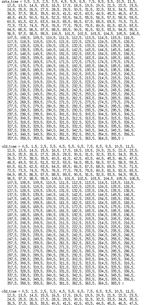

Your times for zeta-_est are between 0.5 and 365.5, but the model time is 0. So model time is not bracketed by the forcing time, hence ROMS won't start.
Either:
(1) Change your initial conditions time to greater than 0.5 days << BEST
(2) Just change the first time in the boundary file to 0 days (instead of 0.5) - this makes the first half day of boundary data not quite right
(3) Add a new time record to the front of the forcing file (e.g. for t = -0.5 days) if you have those data. (If you just copied the data for day 0.5 that would be hold the values constant from t=0 to t=0.5 and then the correct linear interpolation would begin).

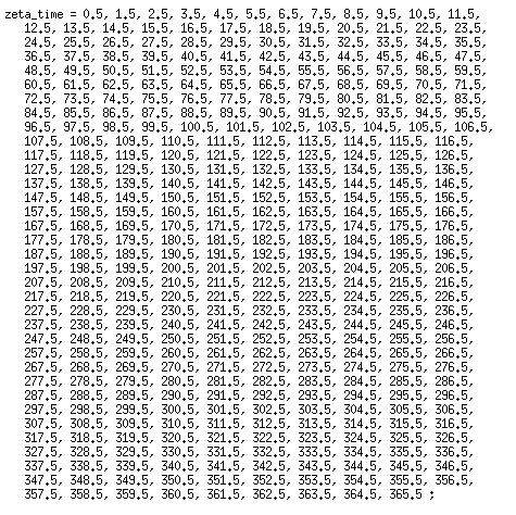

When i change initial time like t = 0, will i change the other kind of times?? For example, ocean time, temp time and salt time and so on.
