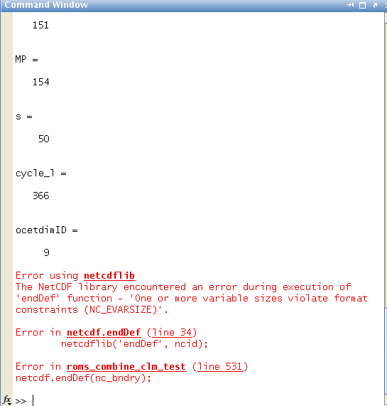

hello
when i want to use nudging method about 3d-field, shoud i need u and v values in climate_file??
if i need u,v values in clim_file, i can't slove this problem.
how can i do??

You have choices. One option is to start by only nudging to T and S and see how that works for you. If you also need nudging to u,v, here are the dimensions of things for one of my files:

Oops, I see I'm going to have to add a "time" attribute to all of these, making the velocities match salt. Anyway, all your horizontal dimensions should look something like this.

There are CDL templates for the various ROMS files in the folder Data/ROMS/CDL (starting from the same level in the hierarchy where you see: Atmosphere, Data, Master, User, makefile ... ROMS etc.)
You can copy and edit those to match your grid dimensions, being careful to maintain the +/- 1 in the respective dimensions. Then create an empty netcdf file with, e.g.
ncgen -b -o myfile.nc template.cdl
