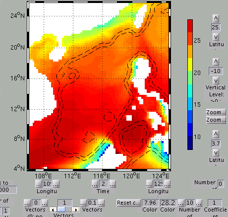

Dear all
I have ran into a problem.My result of Roms is abnormal,the temp is more high in the northern of my areas.
My test_south.in is :

Re: My test_south.in
Is this a surface heating problem or a boundary condition problem? How are you providing the surface heat fluxes? You've commented out BULK_FLUX, so you must be providing some heat flux from outside. If so, you should also provide the dQdSST term.
langlangxie
Posts: 42
Joined: Fri Jul 11, 2014 3:03 pm
Location: Hohai University
#3 Unread post by langlangxie »
kate wrote:Is this a surface heating problem or a boundary condition problem? How are you providing the surface heat fluxes? You've commented out BULK_FLUX, so you must be providing some heat flux from outside. If so, you should also provide the dQdSST term.
Hello,kate.
I made ​​a forced field data by agrifroms.There are shflux,swflux,sst,sss,srflux and dQdsst.As you said,I have commented out BULK_FLUX,if I open BULK_FLUX,can the problem be solved? Or if I still commented out BULK_FLUX,how can i make the dQdSST term into my ROMS,I make '#define QCORRECTION',then i find my temp is normal,but my SSH is so little,look at the picture.is the swflux not provided into ROMS?
thanks in advance!
the SSH is very very little!
So you are saying:
* With QCORRECTION, SST looks good, SSH looks bad.
* Without QCORRECTION, SST looks bad, SSH looks good.
Is that right? I don't know how that could be.
langlangxie
Posts: 42
#5 Unread post by langlangxie »
kate wrote:So you are saying:
kate,I don't mean 'Without QCORRECTION, SST looks bad, SSH looks good'.without QCORRECTION,the SST and SSH are all bad,but if with QCORRECTION,the SST looks better than without QCORRECTION,but the minimize is too small.and the SSH is like Previous figure.So i choose open SRELAXATION term,but the result looks no significant progress.

The result of my ROMS is so surprise!
kate, I created a climate state data,like forcing filed and initial filed .
Thanks a lot!
the ssh is very bad.<br />the sst is so monstrosity,and with some islands is very small
