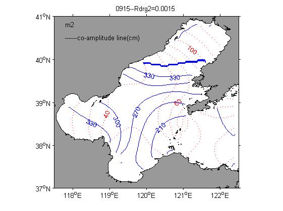

Tanks for your reply! I just want to see the result only forced by the "Amplitude" and the "Phase",I think we could get a good result only by provide "H" and "g", and I'll add the tide velocities later.kate wrote:If you are using TPXO, why not extract the velocities and use them too?
Many of us have troubles with ROMS, but there's more than one kind of trouble. Where do the fields go bad and how do they look?
I plot the "Zeta" (free surface height) of the ROMS result, and I can see regular rising-tide and falling-tide pattern at about 0.8day, this pattern will last for about 3 modeling days and then the "Zeta" field lose the regular pattern and become messy, what's more, my model ran for about 11 modeling days totally.
Additionally, I use the EASYGRID for generating the "_grd.nc" file, I set the maximum "r-factor value" to 0.3, but the "smooth_bath" function can not be up to the standard, I doubt may be the grid file is bad, so what tools do you usually use for generating the grid file? I appreciate it very much for all your replies!

Hi all
When I simulated the tide in Bohai Sea, I confront a problem: the phase of M2 S2 K1 O1 is not good(fig 01), compared to other results(fig NAO_m2),there are large errors. I know the topography and bottom firction are significant to tide. the depth of Bobai Sea is used the newest data ectracted from digital ocean atlas, the boundary condition is forced by 4 tides (M2 S2 K1 O1 )ecactracd from TPX07 tidal data, then modified with NAO99 data, the tidal forcing i checed is right, and i have tried to change the quadratic drag coefficient from 0.0015 to 0.005, the results were no good. I am confused that is there any other parameters needing to change? Give me some advice, please, thank you.
The following is my model setting:

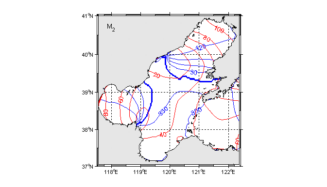

- others' better result

Hianthena wrote:Hi all

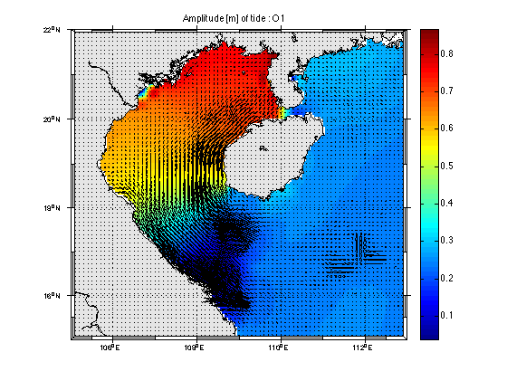

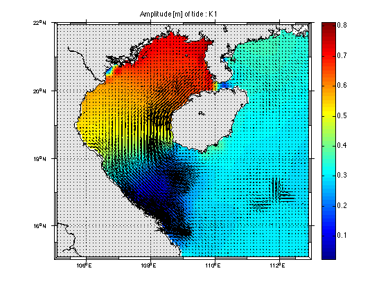

From your post I know that your forcing file is generated according to the TPXO7 data. Recently, I was modeling tides of the Beibu Gulf(China), also, I use the TPXO7 data for making the tide forcing file, however the result is unsatisfying, so I checked the forcing file and found that are some abnormal values in some areas, so I suggest you should check your tide foring file first.

Hi baipeng_up, I know there are some errors in TPX07,in the model I used the amplitude and phase got from NAO99, but the tidal current components is from TPX07, is this the reason of bas simulation?
