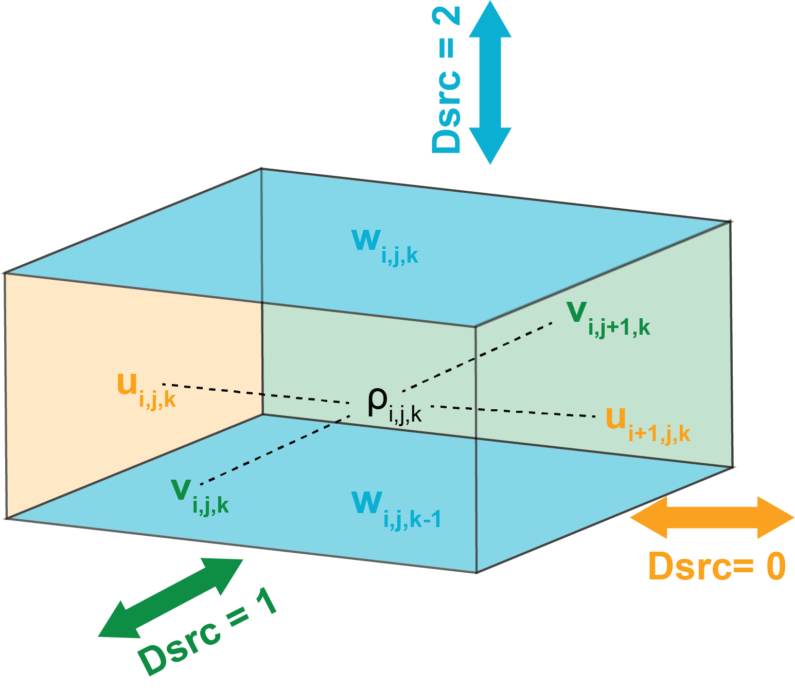

In particular, the NetCDF variable river_direction flag (ROMS Dsrc variable) has a value of 2 to represent the location of the flow across the w-face cell, as illustrated below:
https://www.myroms.org/trac/river_cell.png
Here, the river_direction variable name is confusing and not a good choice, but its value represents the point Source/Sink location on the grid cell.
  Dsrc(is) = 0,  flow across grid cell u-face (positive or negative), LuvSrc = T
  Dsrc(is) = 1,  flow across grid cell v-face (positive or negative), LuvSrc = T
  Dsrc(is) = 2,  flow across grid cell w-face (positive or negative), LwSrc  = T
Notice that advection and divergence operators center the point Source/Sinks effect at the ρ-point (cell center) for all cases.

WARNING:
ROMS is now very strict to how Dsrc is used, as illustrated in the code snippet above. We recommend to revise your input files to use river_direction = 2 when LwSrc is used. It is an inconvenience but we are gaining flexibility.
