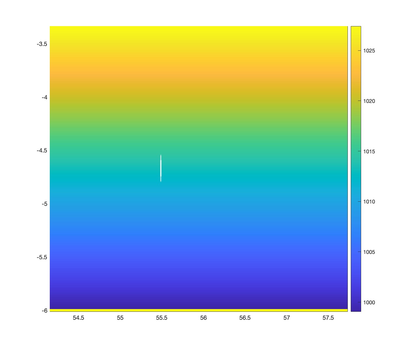

I’d like to report a potential issue I’m encountering when applying non-periodic atmospheric pressure forcing using ana_pair in an idealized model setup.
I'm driving an idealized ROMS simulation using a pressure gradient imposed via the Pair field in ana_pair.h.
I intentionally want all other state variables to remain periodic, but for Pair only, I want the field to be non-periodic, to simulate a steady pressure gradient forcing.
The pressure varies with latitude and is meant to be non-periodic, so I explicitly disabled all periodic boundary exchange for this variable.

When I run the same model in parallel on the new server, the air pressure field (Pair) appears to behave as if it is still periodic, even though:

Despite all of this, the pressure field still appears to wrap around at the domain edges in parallel runs—indicating some form of unintended periodic behavior.

With this change, everything behaves as expected in ROMS 4.1: all variables are treated as periodic except for Pair, which remains non-periodic, as desired. (I've attached the figure showing the correct behavior.)
However, when I copied the exact same changes into ROMS version 4.2, the model does not treat Pair as non-periodic—it behaves as if the field is still being exchanged periodically (figure also attached).
This suggests that something fundamental may have changed in ROMS 4.2 regarding how boundary exchanges are handled, especially with periodicity in distributed memory.
I’m wondering if there have been any changes in how mp_exchange2d or periodic boundary logic is applied in version 4.2 that could be overriding or bypassing my manual .FALSE. settings. Any insights would be greatly appreciated!

This matches the intended setup — turning off periodicity explicitly for the Pair field. However, when I run the model, the behavior still looks like the air pressure field is being treated as periodic, which is quite confusing.
So, even though the compiled analytical.f90 looks correct, the runtime behavior doesn’t reflect that non-periodic configuration. I double-checked everything I could think of, but ROMS 4.2 still seems to override or ignore this .FALSE., .FALSE. flag during execution, while the same setup works fine in ROMS 4.1.
It’s been pretty frustrating, especially since the same logic behaves differently across versions. I really appreciate your support in helping to troubleshoot this — it means a lot.
