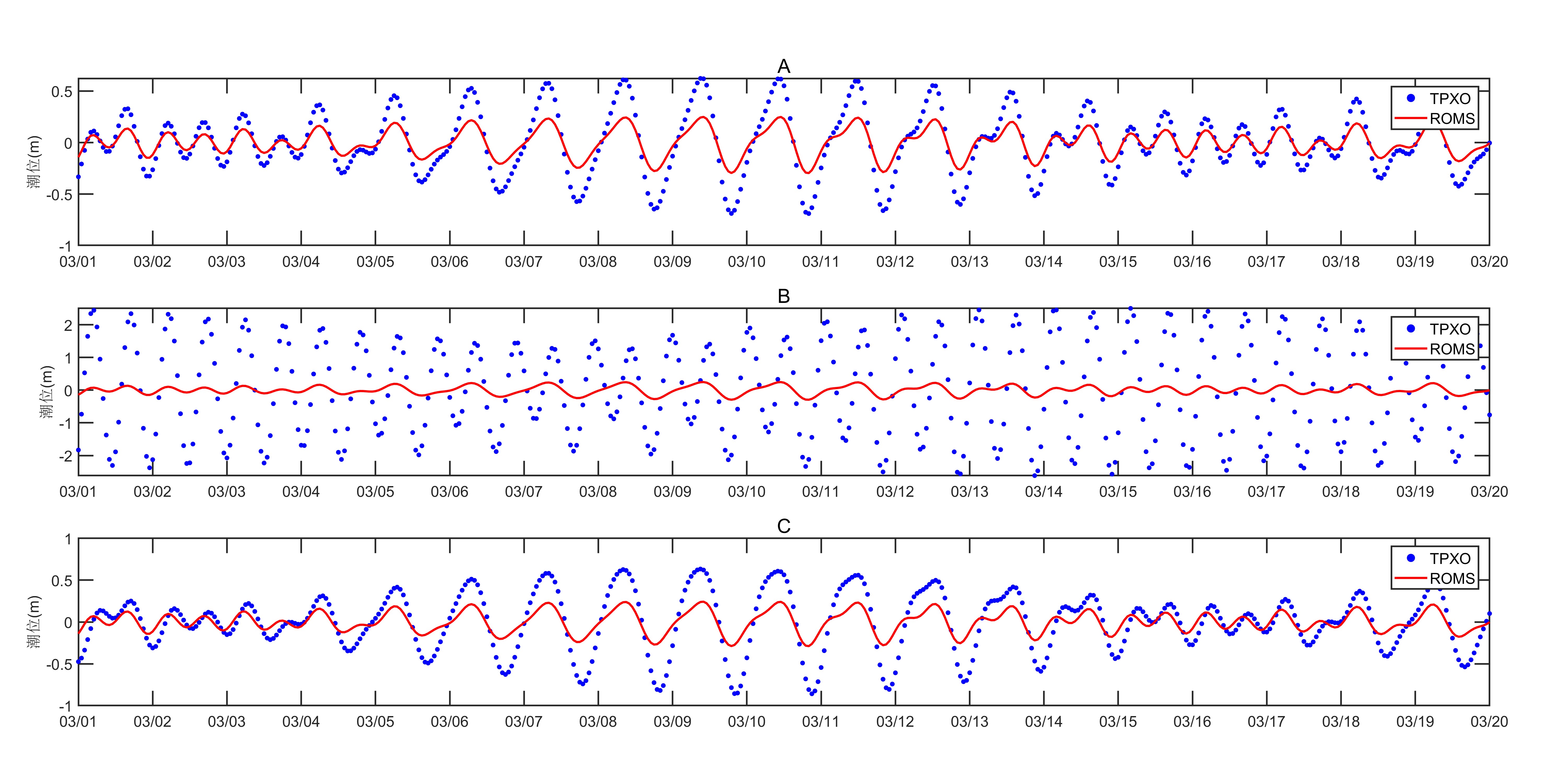

I added tides to my model. The tide data comes from TPXO9_v5, and I used otps2frc(https://github.com/NakamuraTakashi/ROMS ... _atlas30.m) to generate the NETCDF file.
With the addition of tides, my currents are significantly skewed. Here are three images: the average current without tides, the average current with the addition of tides, and the monthly average data from HYCOM
Here are my parameters and CPP options

Appreciate any suggestions :D

Hi everyone, after some time, I'm back with a question.
The descriptions of SSH_TIDE and UV_TIDE say that tidal Forcing is added just on the open boundaries, but my tidal forcing file has tidal Data at every grid point, as does the data in \src\Data\ROMS\Forcing\test_head_frc.nc, which really confuses me.
How can I make sure that the tides are applied to the open boundary and not let the useless data confuse me? Appreciate any help :)

I can confirm that SSH_TIDES and UV_TIDES add harmonic tidal variability strictly at the model perimeter. That the information is provided via a 2-D field on the full model grid is a matter of legacy going way back. The values in the interior are unused for forcing. However, if the DETIDE option is activated this 2-D file format is used to accumulate the on-the-fly harmonic fit that detides the high frequency output.
If your high-frequency HYCOM output is for a model with resolved explicit tides, then yes, you have tides times two.
Something else to consider in a domain this large is whether the luni-solar tide generating forces are significant. In our model the Indonesian Seas we found these forces actually act to reduce tidal energy in some regions by working against the strictly boundary forced tide. You might consider activating #define TIDE_GENERATING_FORCES

Thanks to MoeinDst for the index and wilkin for your patient explanation, you really helped me a lot. :D
I chose to modify my tide input file to keep only the values for the boundary grid points and set all the data for the internal points to 0. Everything looked much better, except for the tide itself. Right now my tides are far too small compared to TPXO's predictions, which I've been running my model for 60 to 80 days, and the elevation is only half as high as expected, with even more depressing results in the Taiwan Strait(B).
