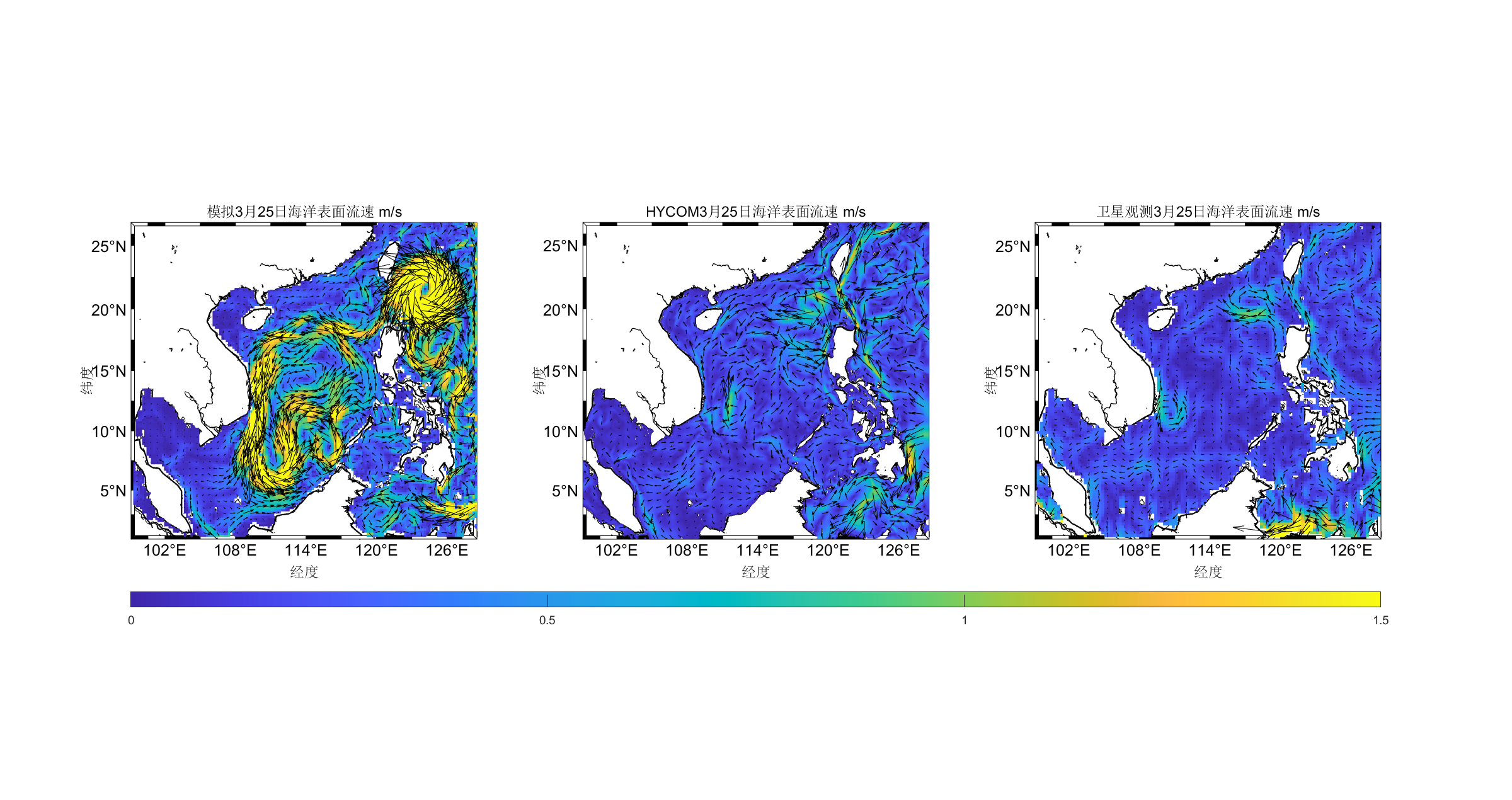

After three months of operation, my model had this problem. As shown in the picture, it lacked the Kuroshio flow from Taiwan Island to the Philippines, which caused a large amount of warm current to flow into the southern waters of Indo-China Peninsula. I want to know how to solve this problem
Thanks for any suggestion
My model's Kuroshio is gone

I checked the previous experiment and found that after I changed the value of obcfac to 0, my model had an unexplained vortex in eastern Taiwan. In fact, in most of my other experiments, similar vortexes were present, with a strong current moving south along eastern Taiwan, while the northbound current from the Philippines had to shift east
This is the image at obcfac=0, with the roms model, HYCOM data and satellite data from Oscar from left to right

Dear jcwarner, thank you very much for your helpful explanation. However, this vortex is still bothering me, as it still exists when I set the OBCFAC to 10 or 100, albeit not as noticeably.
