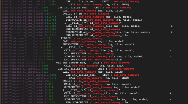

As for the grep suggestion, the output from that command is attached. The ROMS/Nonlinear/ini_fields.F is the file that is triggering the error but I'm not sure how to find which header feature is triggering the error

#5 Unread post by jcwarner »
as i look thru the ini_fields, i see set_zeta_timeavg, but it is inside a solve3d loop, for example:
925 # ifdef SOLVE3D
926 !
927 !-----------------------------------------------------------------------
928 ! Initialize fast-time averaged free-surface (Zt_avg1) with the inital
929 ! free-surface
930 !-----------------------------------------------------------------------
931 !
932 CALL set_zeta_timeavg (ng, tile, model)
933
the only part that is not, is near the top.
PUBLIC :: set_zeta_timeavg (line 58)
maybe try
# ifdef SOLVE3D
