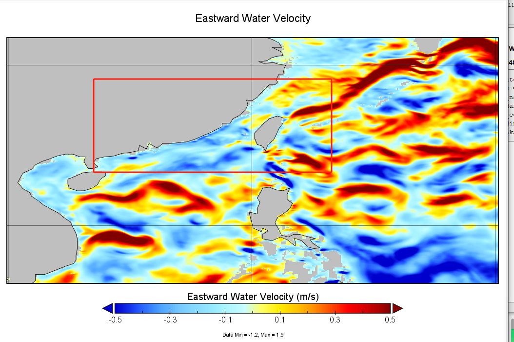

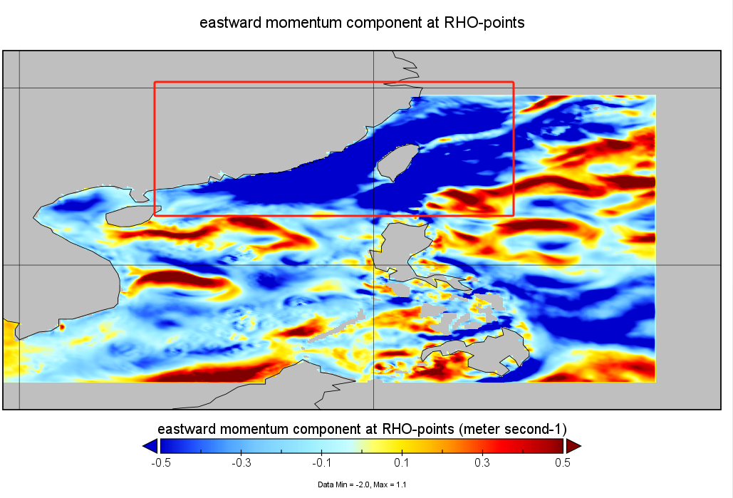

I am running a test, and the surface velocity in the ROMS result file is obviously too large compared with hycom.
roms result:
hycom data:

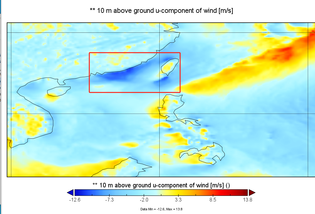

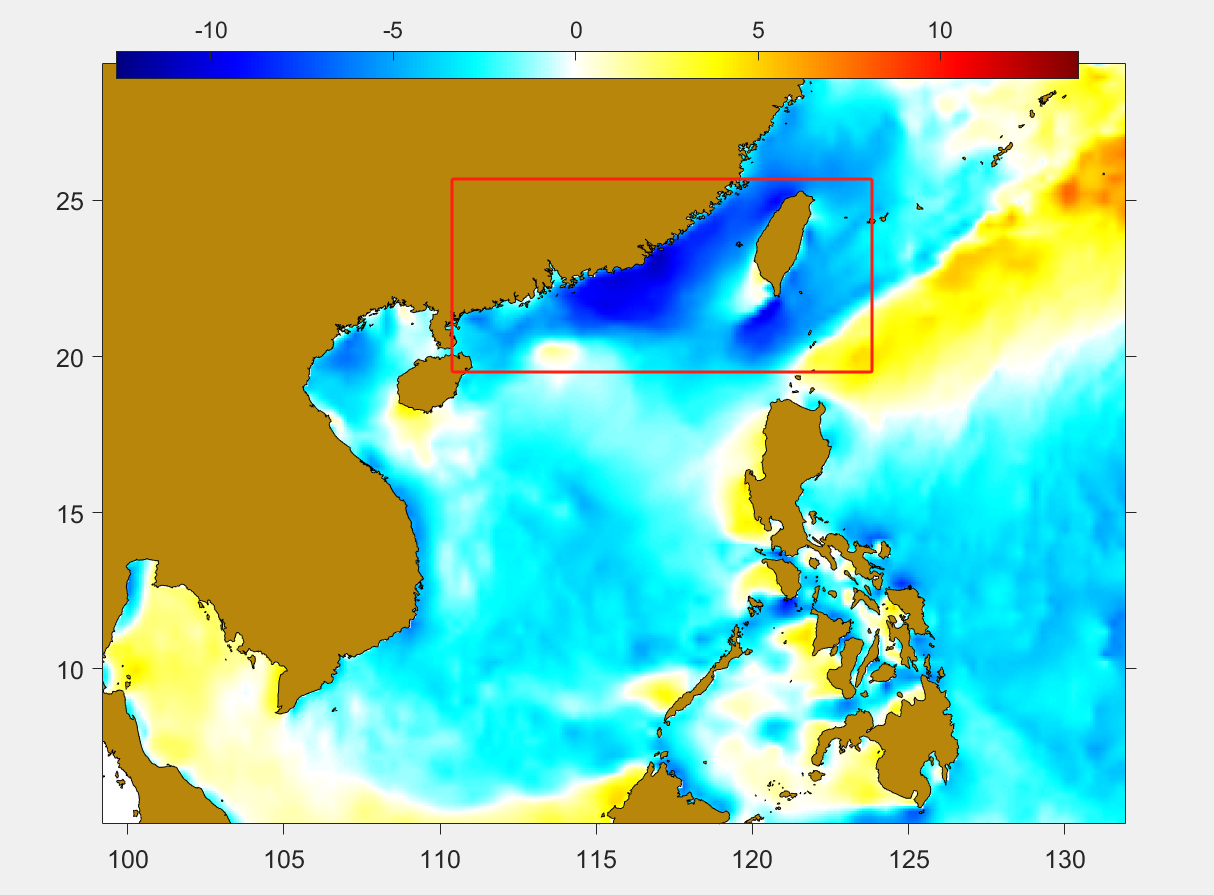

Then I output uwind and vwind in his file, and compared with the input wind field of 10m, the output uwind of roms is also too large.
roms:
GFS:
Is that normal? Is my excessive surface flow a problem with the wind field?

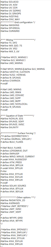

this is my define file:
