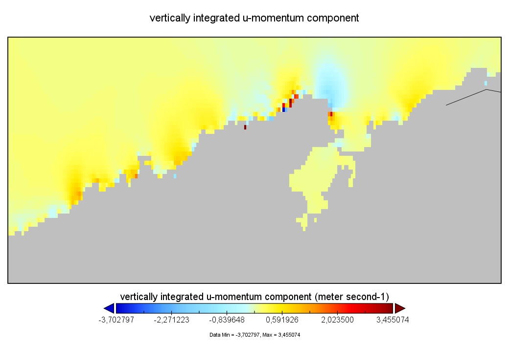

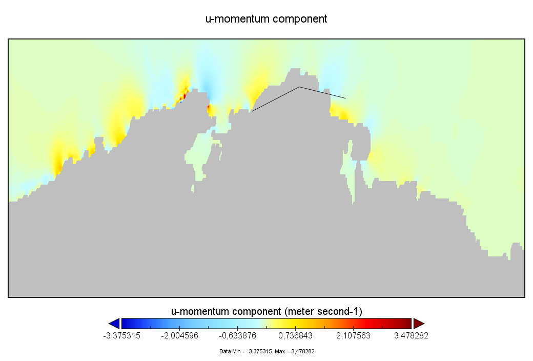

Yes, I've.
I opened it and near at the coast, the values are biggest than the normal.
The u, v, ubar and vbar have the same problem and in the same location.
Do you think that I should change the depth of my mesh near at the coast for theses points?

Re: Problem with Blowing-up, REASON: MaxSpeed = 2.5E+01
you need to do something there.
not sure what the bath looks like. maybe a little smoothing there. maybe increase visc2 a little.
maybe decrease time step. try a few things.
