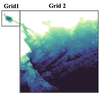

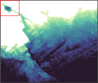

I am building a composite nesting model with increased resolution in the northwest corner (highlighted in red) but I have some problems creating the contact file with contact.m.
In a very basic test, I divided the model domain into a left and right grid with grid_extract.m and the contact file was created successfully with contact.m. Note that the left and right grid had same model resolution in this case. With this, I established that the scripts work in principle.
I then divided the model domain into an upper left and right grid (see below) with grid_extract.m to get a more sensible set-up. The two sub-grids had same resolution. In this case, when I ran contact.m I got this error:

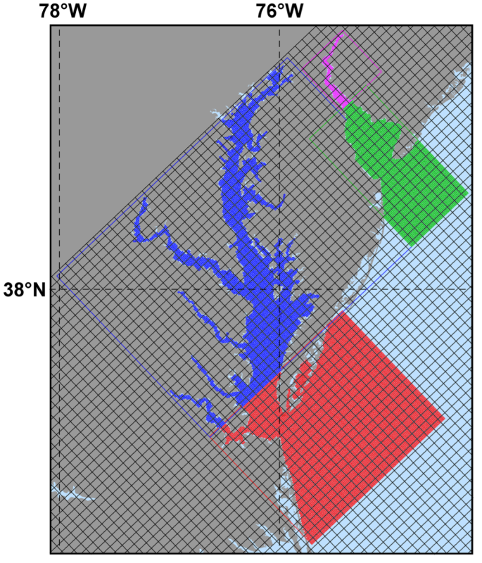

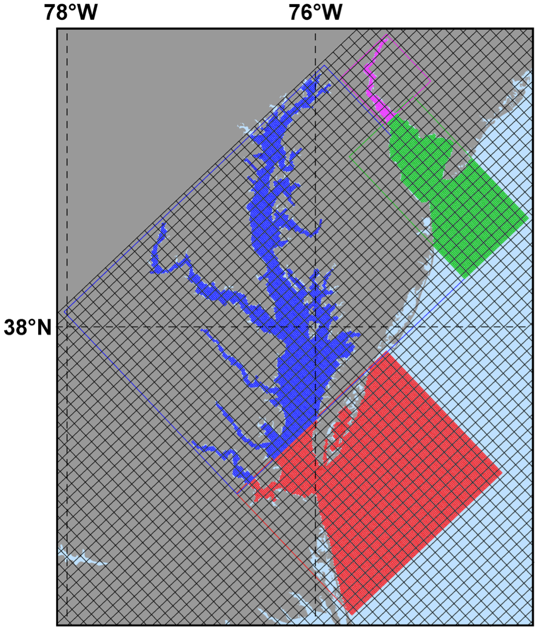

The error was because the two sub-grids had different sizes along the overlapping boundary. However, looking at the example of the US east coast on the ROMS wiki (https://www.myroms.org/wiki/Nested_Grid ... East_Coast), e.g. the blue and red grids shown below, this should work.
