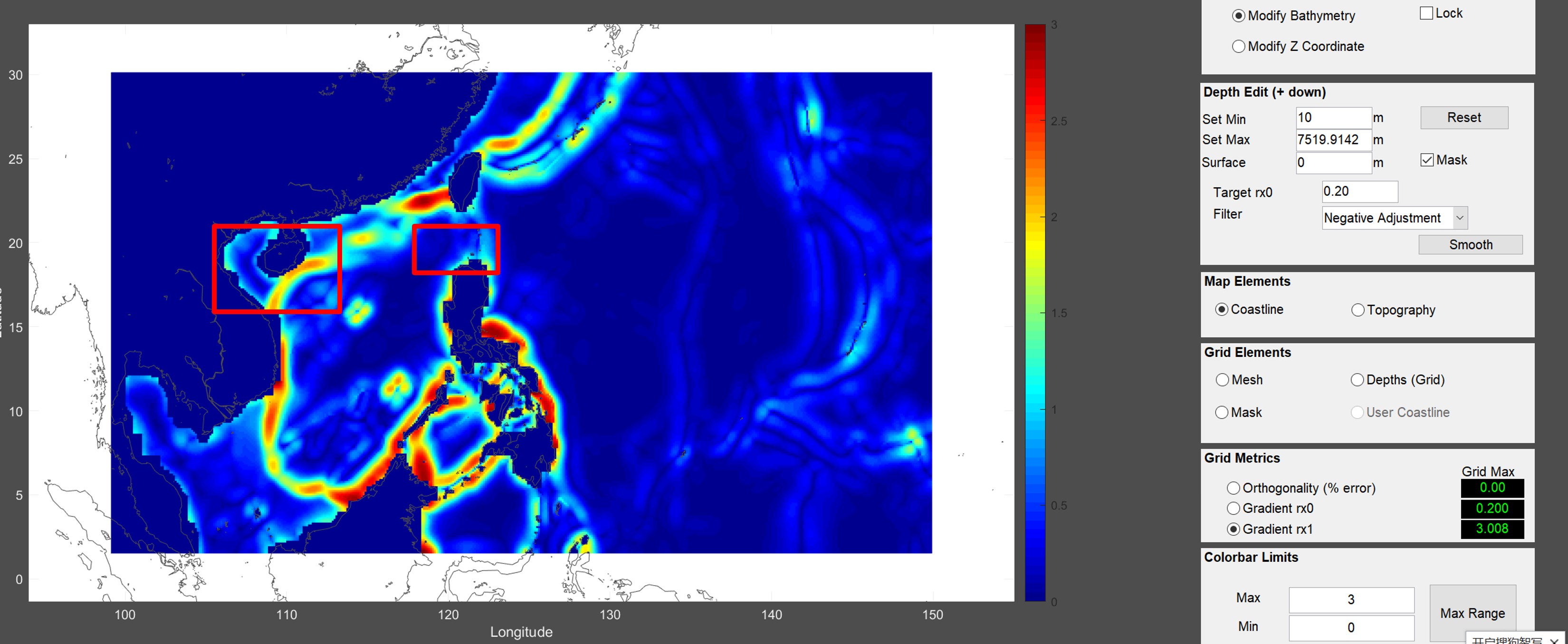

I simulated an tropical cyclone event using ROMS in Northwest Pacific region. I found the SST on the west side of Hainan Island, China, is lower compared with the observations (There is always a cold water inexplicably appearing there). I have modified many vertical parameters (i.e., 30 levels to 16 levels vertically and smooth the bathymetry..) and found that this phenomenon has not changed. I further found that areas with poor SST simulation may match areas with larger grid file RX1 (see the Figure).
Here is my ROMS grid with horizontal resolution of 12 km:

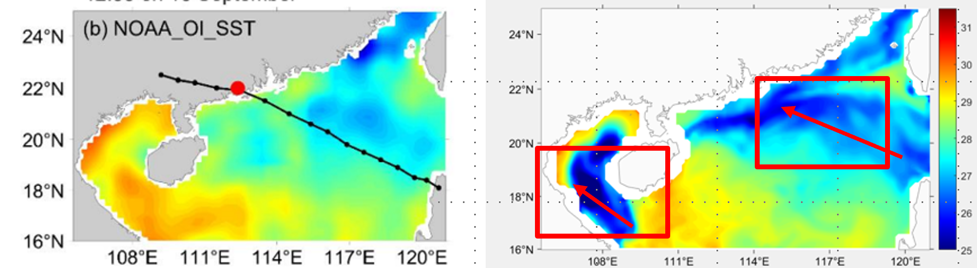

Here is the comparisons with the observations from NOAA. The red box represents the area of SST simulation anomalies, and the red arrow represents the direction of cold water spread:

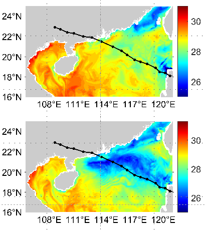

Actually, I have obtained good simulation results using a ROMS grid with horizontal resolution of 4 km and 16 levels vertically in a relatively smaller study area (see figure below).

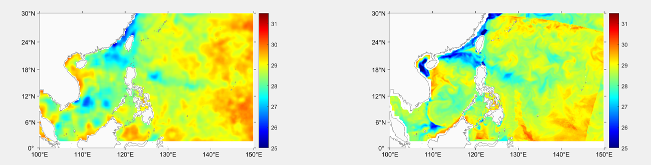

Actually, I used WRF-ROMS coupled model and I find there is an unusual decrease in SST at the boundary (see Figure below):
The left is the NOAA data and the right is my simulation results.
