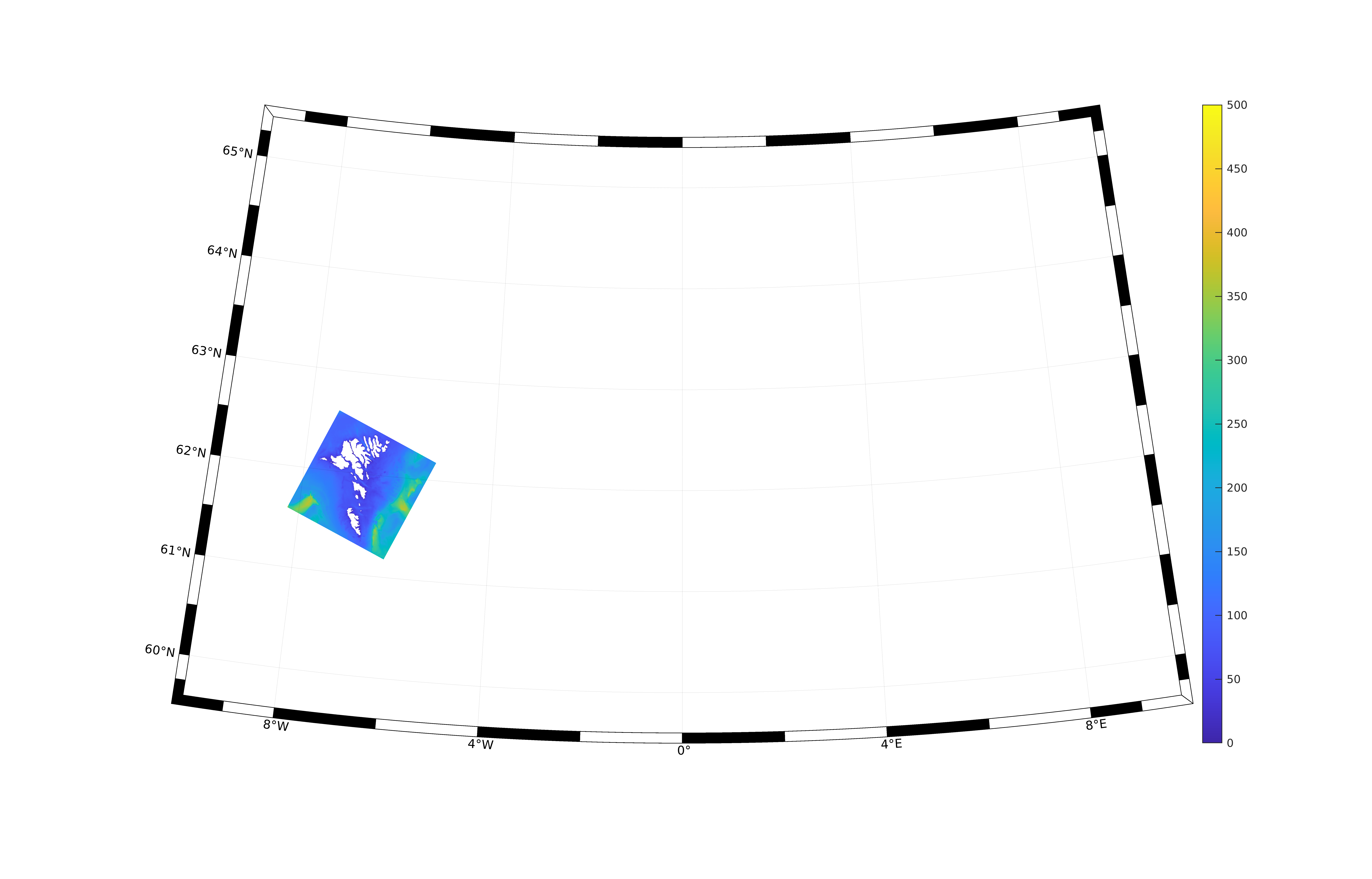

I am running a nested version of ROMS around the faroe shelf and my nested domain keeps blowing up, with out any obvious reason. I have tried to reduce the Haney number. but then it still blows up. I would like keep at least 35 vertical layers, and have 400 m horizontal resolution. The area has some steep bathymetry.
I have run a 2kmx2km domain that runs fine, which I use as boundary forcing, if I reduce the time step to 0.01 seconds it runs for 17 timesteps.
